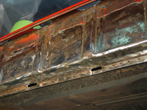

These clamshell over the outside of the longitudinal, which hasn the weep holes along the bottom. Most guys just smash the weep holes flat and clamp on the clamshell. What I do is cut them off with a cut off wheel and then bump the metal flange inward to make the weep hole still funtional.

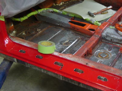

I also cut windows in the sill right above the stiffening ribs, and weld the clamshell at the top of those vertical ribs.
Here's the little "windows"
Here's the weep holes cut off
