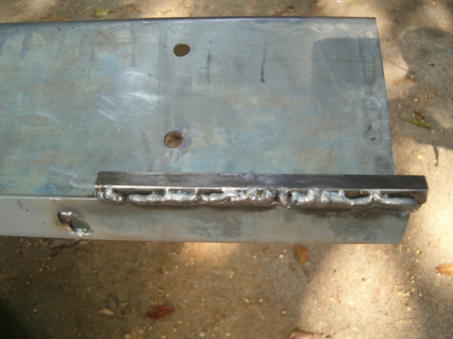

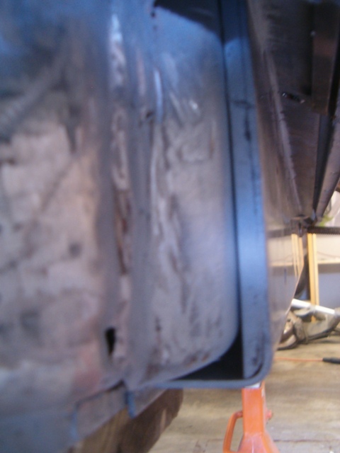

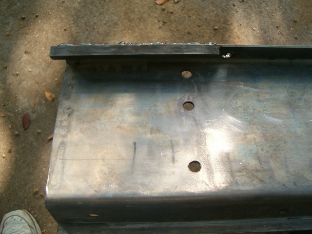

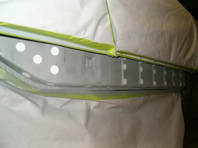

Here are a few more photos I have of my install -
Photo #2 shows the additiona of the 1/4" rod to fill a gap as well -

Great pictures. = ) Did you drill holes and weld through the holes or did you just go around the outside? Also, from the web site pictures it looks as though the door sills have to come off... But yours look like they went on under it... Do you have any more pictures? = )

dakotaewing   Eric - I drilled the holes in the top of Brads kit...   Oct 26 2009, 08:04 AM
