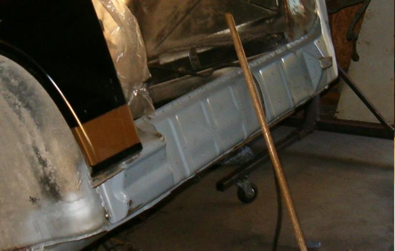

Does any body make a stiffening kit that can be welded to the outside of the long?

ConeDodger   Yes but I am at a loss to remember who it is... do...   Oct 23 2009, 08:12 PM
ahdoman   As always, I tried that already. The problem is th...   Oct 23 2009, 08:36 PM
MDG   AA sells the clamshells that go on the outside; I ...   Oct 23 2009, 08:38 PM
Grelber   I got mine from Brad Mayeur at 914ltd.   Oct 23 2009, 08:55 PM
Bruce Hinds   I bought a set many years ago from an outfit calle...   Oct 23 2009, 09:11 PM
ahdoman   Thanks all. The only thing I could find at AA is...   Oct 23 2009, 09:56 PM
Heeltoe914   Steve what is your purpose? Are you looking to rep...   Oct 23 2009, 10:27 PM
Cire   Steve what is your purpose? Are you looking to re...   Oct 24 2009, 06:19 AM
tat2dphreak   THIS is the one you WANT. it ties the suspension...   Oct 23 2009, 10:30 PM
Heeltoe914   I am sure Brad makes good stuff. anyone have pics ...   Oct 23 2009, 10:34 PM
ahdoman   Unfortunately it looks like "the turd" h...   Oct 23 2009, 10:48 PM
dakotaewing   Here is a few pics of one of Brads older kits with...   Oct 23 2009, 11:20 PM
r_towle   George Hussey (AA) designed the original clamshell...   Oct 23 2009, 11:22 PM
pete-stevers   not sure but i think chappy has them installed on ...   Oct 23 2009, 11:54 PM
Rand   Just check it all out. There are some very knowled...   Oct 24 2009, 12:02 AM
shoguneagle   I went to both extremes - I welded Brad Mayeur...   Oct 24 2009, 01:15 AM
Grelber   Here's a pic of my passenger side with the Bra...   Oct 24 2009, 07:57 AM
Cire   Here's a pic of my passenger side with the Br...   Oct 24 2009, 08:49 AM
Grelber   Here's a pic of my passenger side with the B...   Oct 24 2009, 12:25 PM
Justinp71   Looks great. Did you do the work yourself? Do ...   Oct 25 2009, 07:36 PM
carr914   AA sells the clamshells that go on the outside; I...   Oct 24 2009, 09:28 AM
tat2dphreak   those are just the clamshells too, I think, on AA....   Oct 24 2009, 09:44 AM
r_towle   George designed the original overlay that Restorat...   Oct 24 2009, 10:01 AM
Bartlett 914   Brad's kit is awesome! We are about to cut...   Oct 24 2009, 12:47 PM
Heeltoe914   Steve what is your purpose? Are you looking to r...   Oct 24 2009, 07:22 PM
9146986   The Restoration Design pieces are lighter and perf...   Oct 25 2009, 09:22 AM
GeorgeRud   I've had Brad's kit on my conversion -6 fo...   Oct 25 2009, 10:42 PM
dakotaewing   Here are a few more photos I have of my install - ...   Oct 25 2009, 11:10 PM
Cire   Here are a few more photos I have of my install -...   Oct 26 2009, 06:53 AM
Cire   Here are a few more photos I have of my install ...   Oct 26 2009, 06:58 AM
JazonJJordan   :popcorn:   Oct 26 2009, 12:05 AM
dakotaewing   Eric - I drilled the holes in the top of Brads kit...   Oct 26 2009, 08:04 AM

ClayPerrine   I think some of you are missing the difference bet...   Oct 26 2009, 10:15 PM
Red72   This seems to be the best thread on the 914Ltd (Br...   Oct 4 2016, 10:20 AM
injunmort   no, after all the welding, they look great. no gri...   Oct 4 2016, 05:26 PM
Red72   no, after all the welding, they look great. no gr...   Oct 4 2016, 06:21 PM
marksteinhilber   The longitudinal is designed as a box section beam...   Oct 5 2016, 01:34 PM
marksteinhilber   Oh, OSPHO or other rust remover can be used to arr...   Oct 5 2016, 01:53 PM
marksteinhilber   I learned plenty from this website. Jack point re...   Oct 5 2016, 02:04 PM
