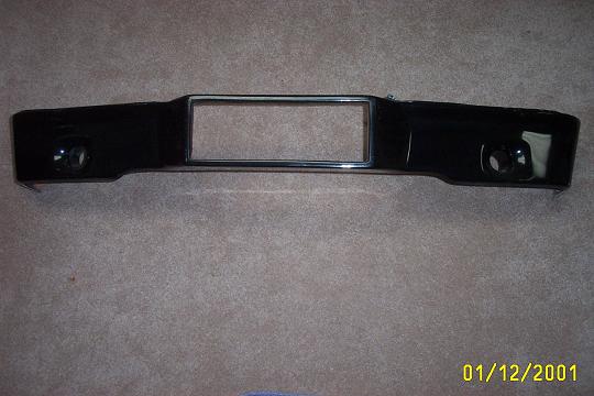

I might just have what you're looking for!!! And I'm wanting to sell it!
Here's some pics for ya!
Let me know!
It's out of the GT Racing catalog

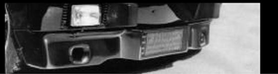

SirAndy   Some of the GTs used a similar setup. I've got...   Oct 28 2009, 12:56 PM
