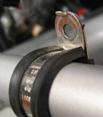

I like the placement. Are you sure you want to trust the zip ties. I think I'd use a clamp like the one pictured below. Much stronger and is secured with a bolt, not glue.
rfuerst911sc
post Oct 27 2009, 07:13 PM
Posts: 2,158
Joined: 4-May 06
From: Dahlonega , Georgia
Member No.: 5,980
QUOTE(jmill @ Oct 27 2009, 04:48 PM) *
jmill I work in the defense contractor business so I do have access to these clamps you have in the pic. However I didn't want to drill the holes into the floor pan. I ground the paint/primer to bare metal and glued the tie plates with JB weld so I don't think they are easily coming off. The zip ties I used are pretty heavy duty but surely not as strong as the clamps. I guess once I get the car running and get some heat cycles thru the hoses I'll see if there are any issues. I guess I could safety wire them in case a zip tie let go. Good feedback thanks.
