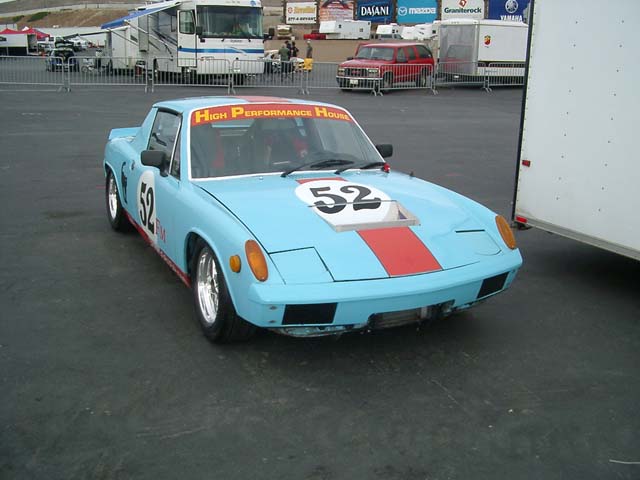

'back in the day' I had the same setup.
(IMG:http://www.pelicanparts.com/914/914_photo_gallery/braun_914.gif)
I ran the lines behind the passenger side rocker panel though.
I eventually moved it inside the front trunk and vented the exhaust upwards. Here's a pic without the front airdam & splitter showing the cooler.
Good job though! My first setup worked well. I'm sure it will work well for you too.
