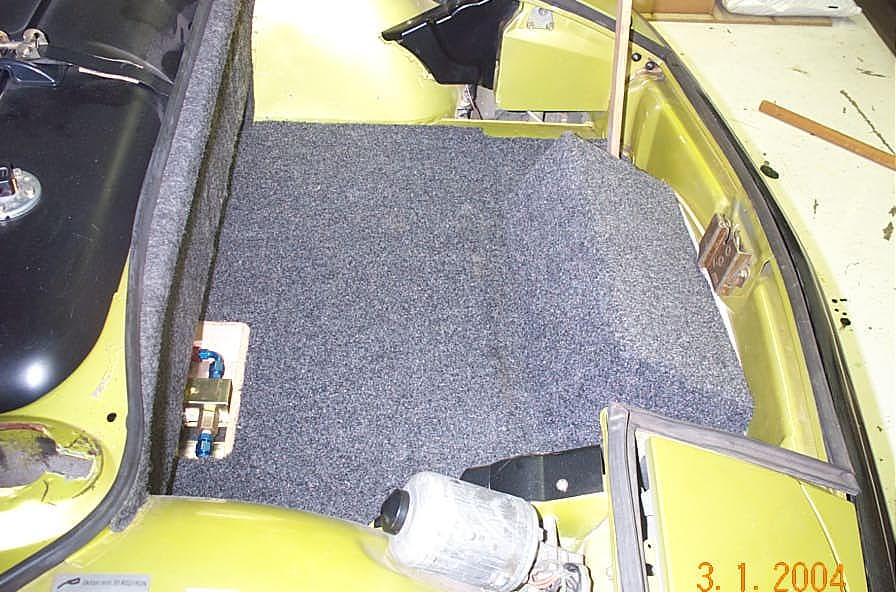

I do some thinking also. I passed this way bout 10 years back. Everything is out of harms way. The spare is gone tho..... a small inconvience. I haven't had a flat in 30 years. If you think you have it handled, it must be true.
An old pic
