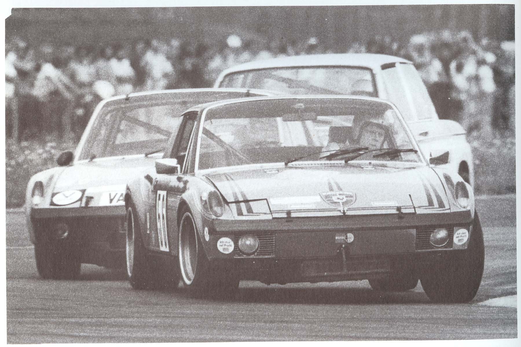

Crappy pic, but you get the idea ...

SirAndy   Some of the GTs used a similar setup. I've got...   Oct 28 2009, 12:56 PM

race914   'back in the day' I had the same setup. h...   Oct 28 2009, 02:42 PM

iamchappy   I used to have the GT spoiler on my first 914 with...   Oct 28 2009, 03:54 PM

SirAndy   Crappy pic, but you get the idea ...   Oct 29 2009, 12:03 AM
