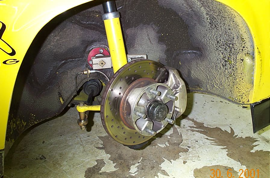

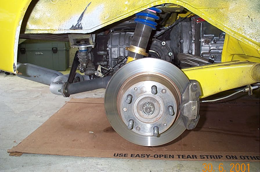

Racing916   Brake Update Pictures of the front and rears, than...   Dec 4 2009, 06:58 PM
Racing916   front   Dec 4 2009, 06:59 PM
Racing916   rear   Dec 4 2009, 07:00 PM
Eric_Shea   :trophy:   Dec 4 2009, 09:03 PM
Racing916   :trophy: Thanks for all your input Eric!   Dec 5 2009, 07:20 AM
