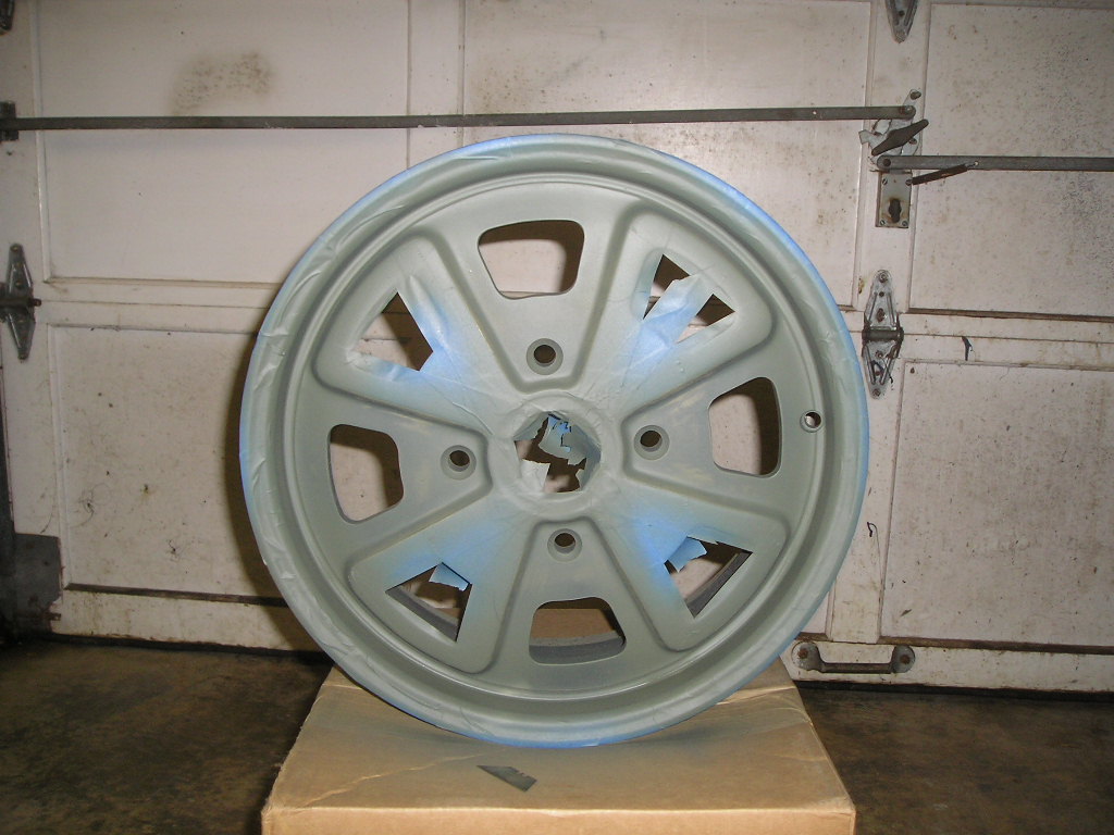

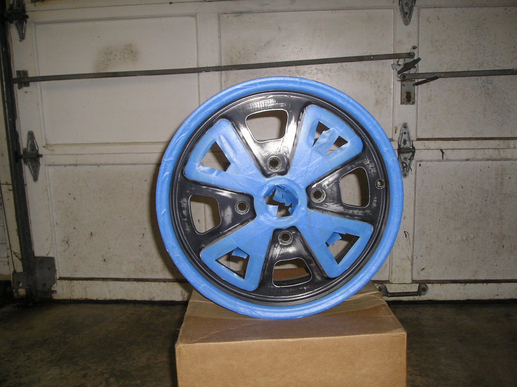

First off I got some new tires for it. The only problem is that my Fuch wheels aren't ready to have the tires mounted. I have been working on cleaning them up and painting them. So far I have two of the wheels almost ready for a clear coat.
I don't have a before picture but here is a picture after I cleaned the wheels up and masked them for paint.
Primer
And some black...

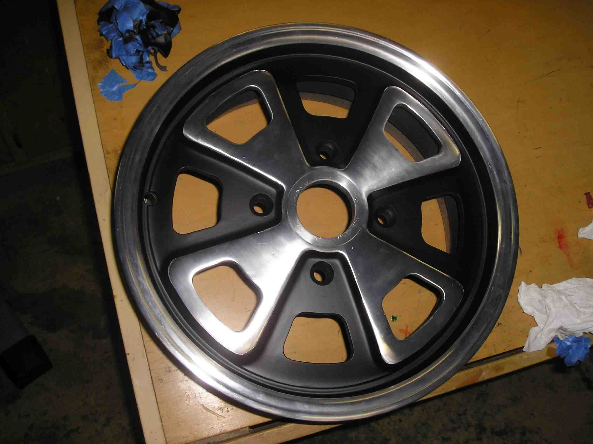

dlee6204   I finished the rest of the wheels today. Here...   Dec 6 2009, 10:21 PM
dlee6204   Finished product   Dec 6 2009, 10:25 PM
dlee6204   Now I just need to get the tires mounted. Tha...   Dec 6 2009, 10:26 PM
