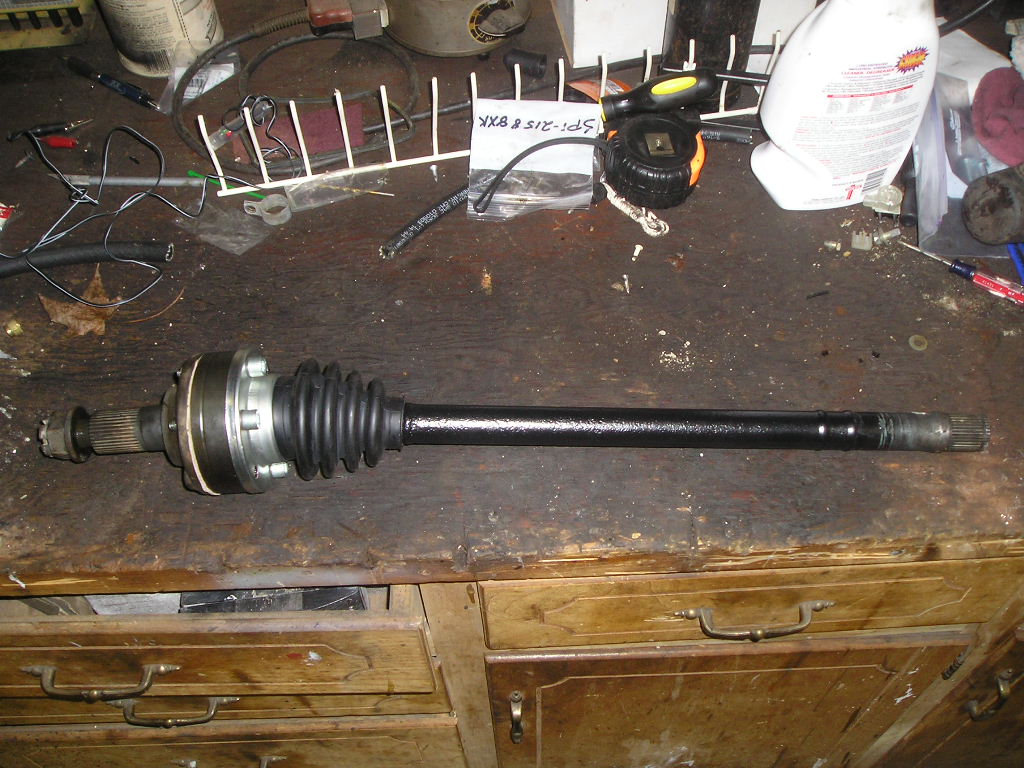

I also started rebuilding a set of axles that I had lying around. I finished one and the other will get done shortly.

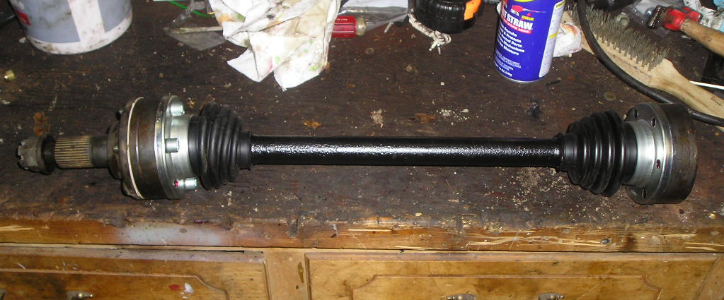

dlee6204   Finished up the second driveshaft... Oh my... C...   Dec 5 2009, 12:54 PM
