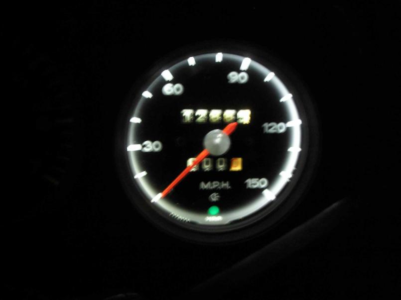

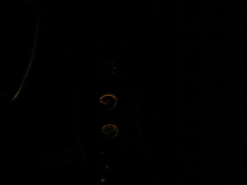

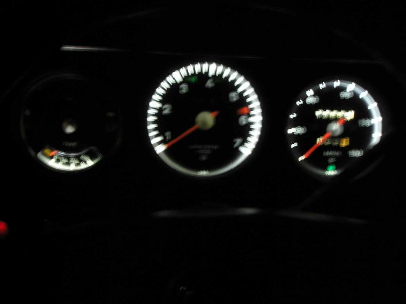

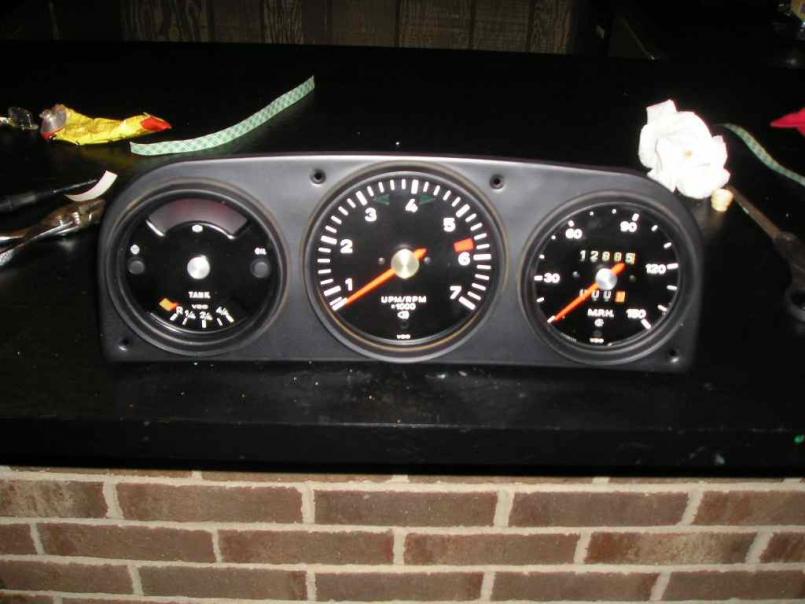

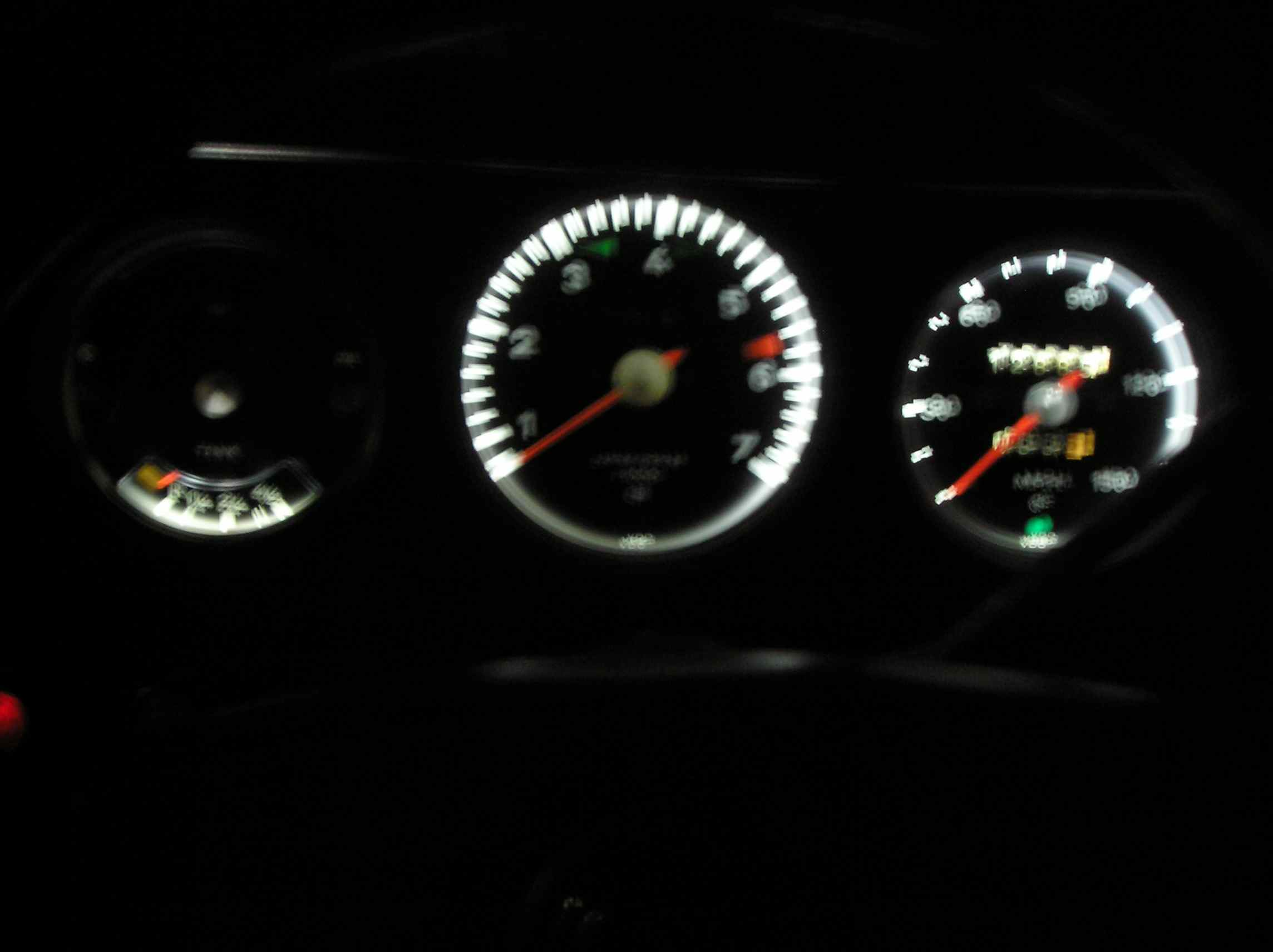

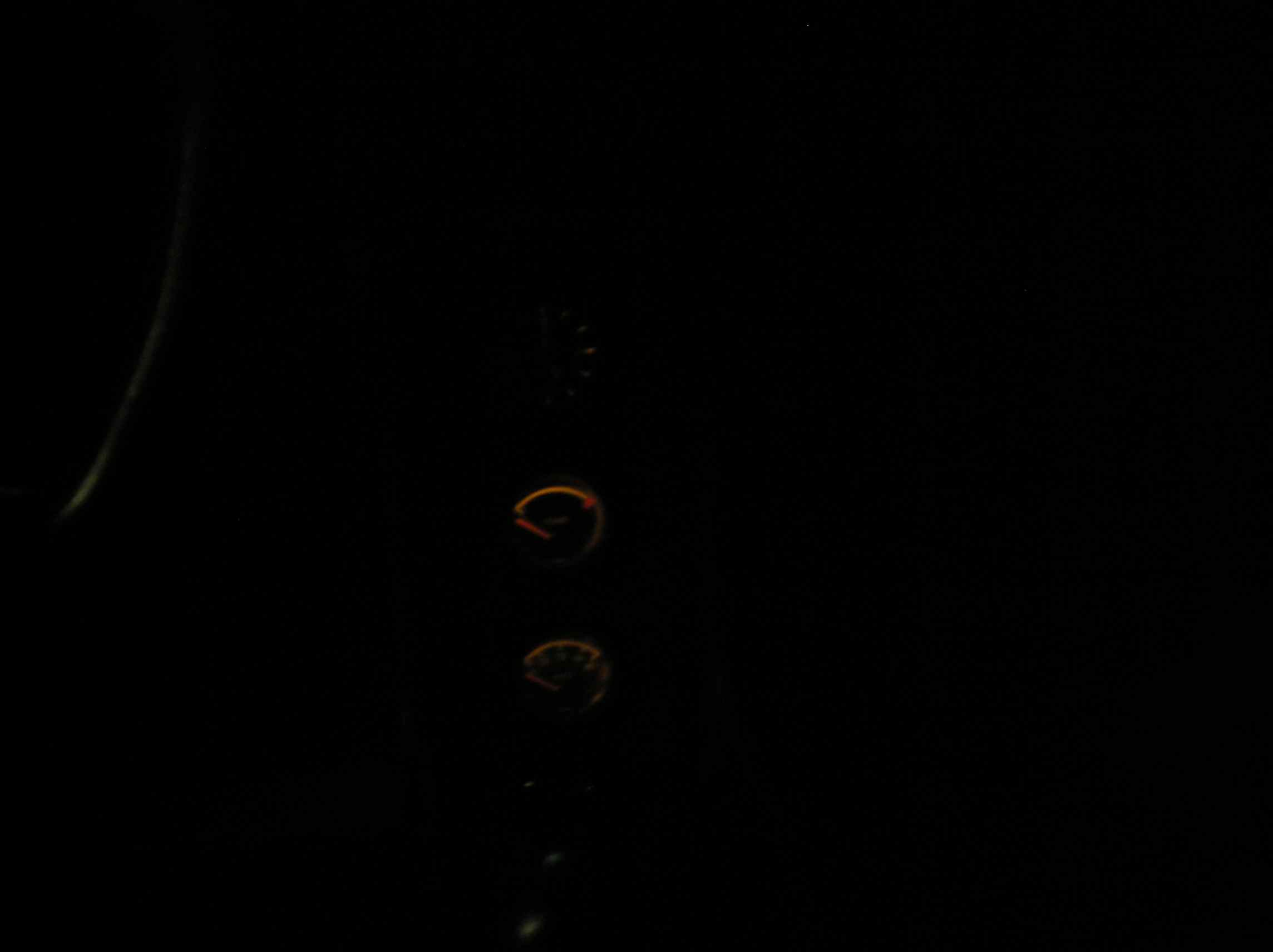

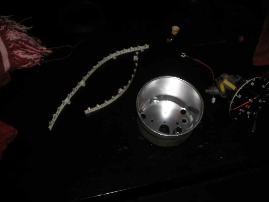

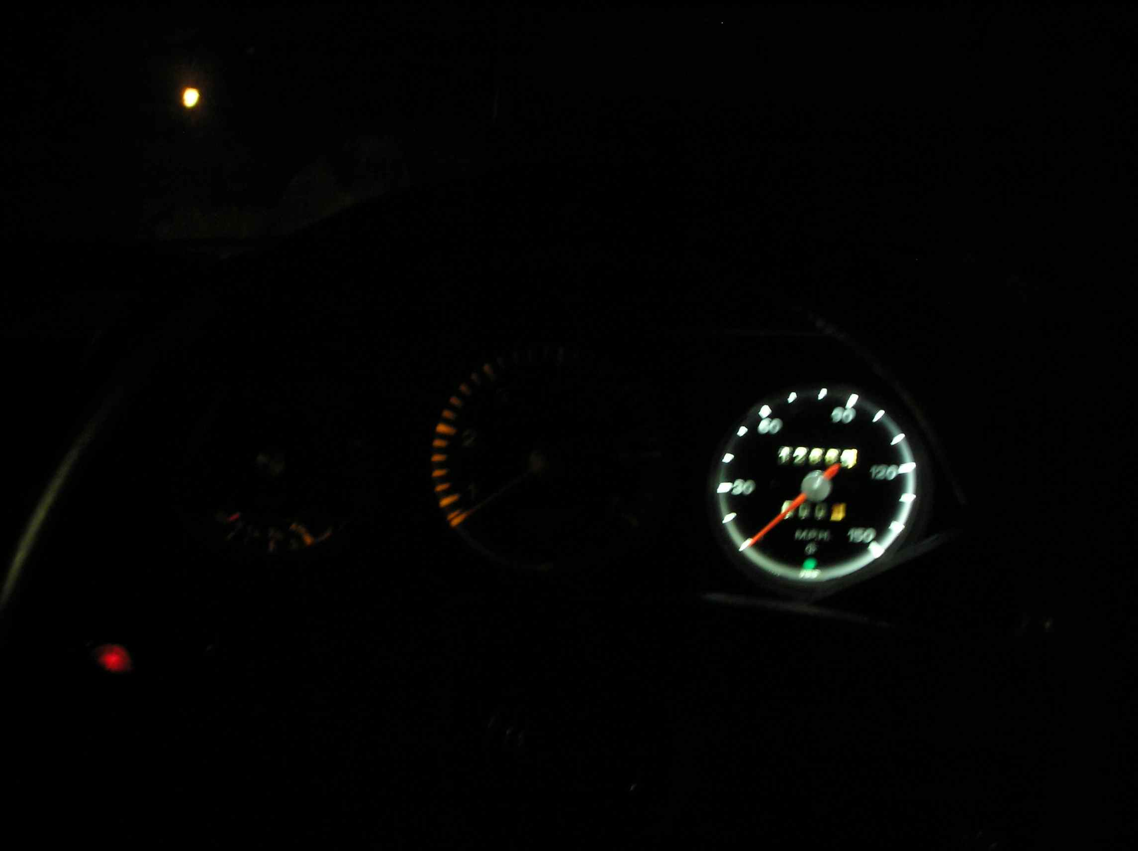

So I did something SAWEET to my car last night. I installed White LED Strips in the gauges to get rid of the yellow halogen bulbs. It came out looking great.
(I apologize for the blurry pictures)
I took the gauges apart, painted the interior housing a more reflective color, and installed a strip of LED's and wired it out the back. The difference is staggering.
The parts...

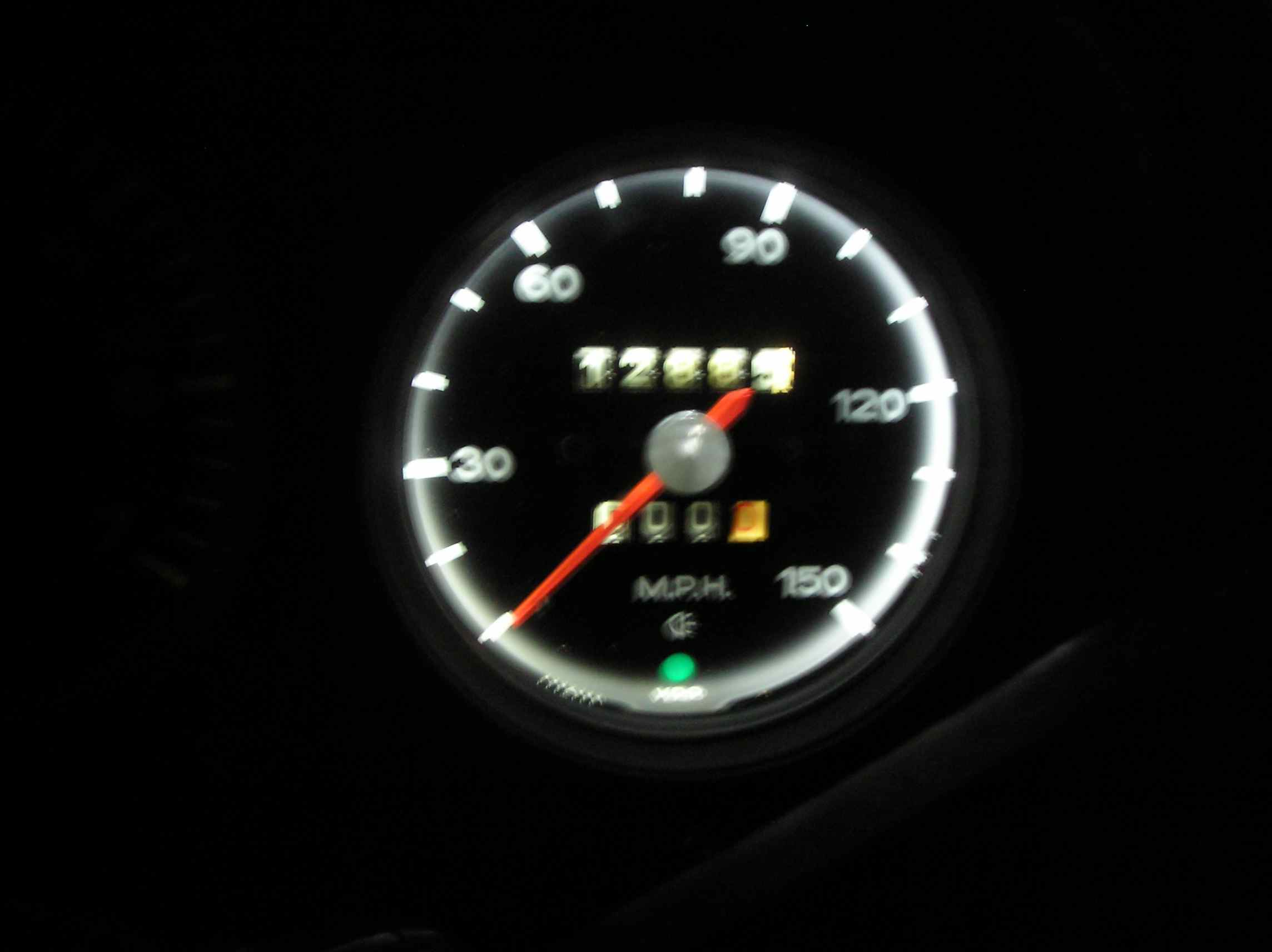

After I finished the speedo. This shows a big difference. I might be able to see my gauges now... (IMG:style_emoticons/default/w00t.gif)

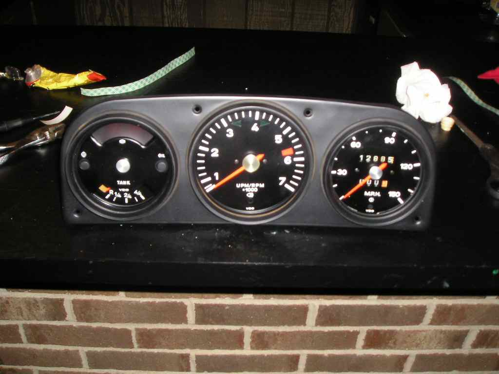

Complete assembly. I also painted the rings on all three gauges as well as the mounting plate.
Now I just have to do the center console gauges.
