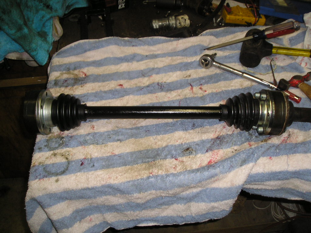

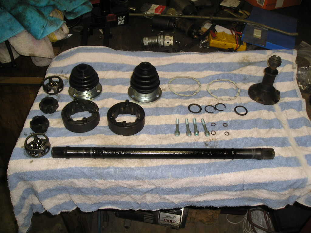

Finished up the second driveshaft...
Oh my...
Complete!
