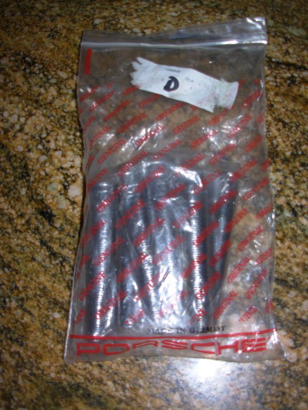

Glenn I have some 100mm studs if you need them.
T.C.

carr914   Glenn I have some 100mm studs if you need them. T...   Dec 6 2009, 06:52 AM
FourBlades   Glenn, That looks great, you most be stoked! ...   Dec 7 2009, 06:20 AM
gms   T.C. Thanks for the offer, I already have a set, j...   Dec 7 2009, 08:37 AM
