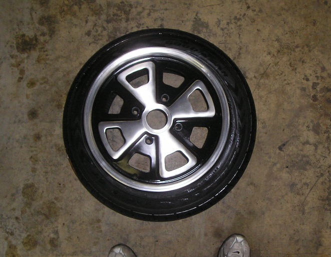

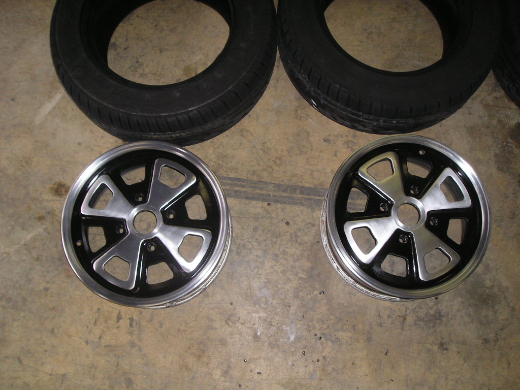

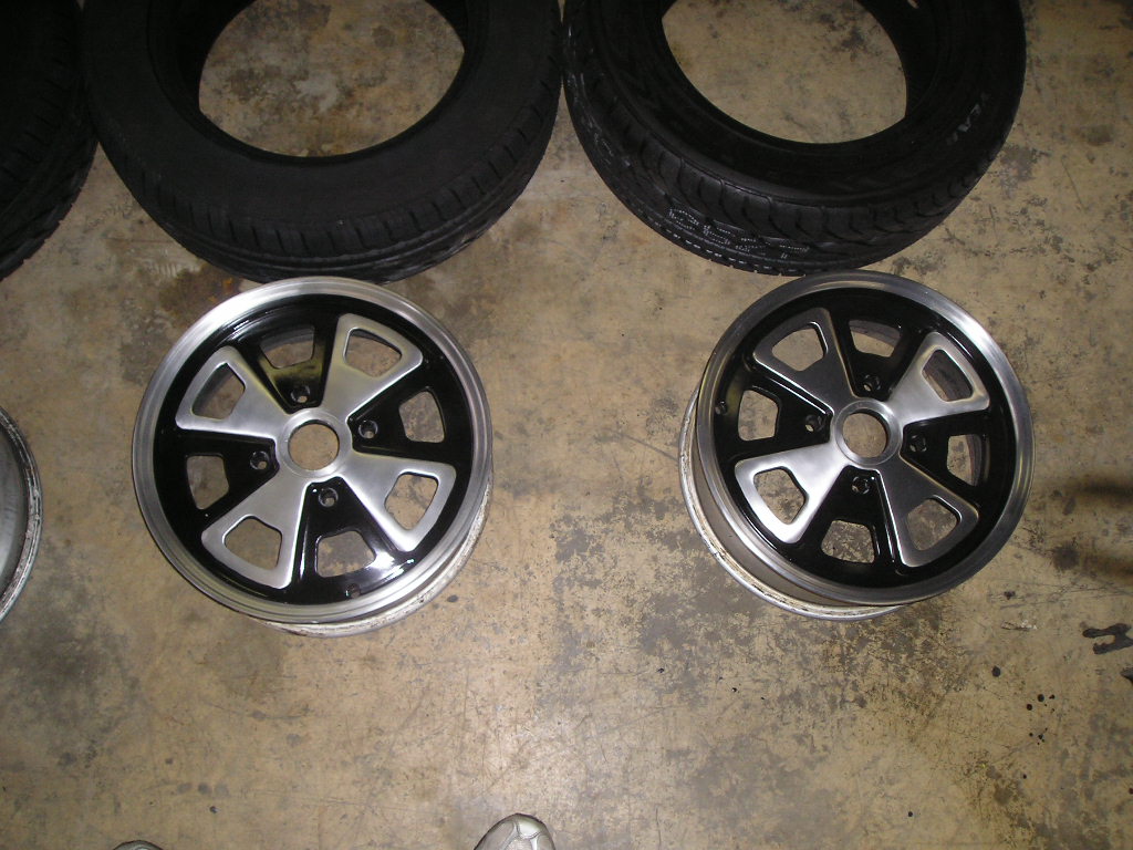

dlee6204   I finished the rest of the wheels today. Here...   Dec 6 2009, 10:21 PM
dlee6204   Finished product   Dec 6 2009, 10:25 PM
dlee6204   Now I just need to get the tires mounted. Tha...   Dec 6 2009, 10:26 PM
