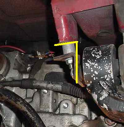

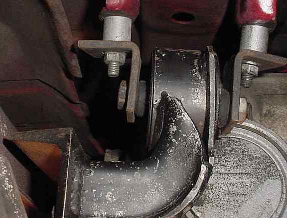

I'd be replacing those tranny mounts ASAP

(IMG:style_emoticons/default/agree.gif) I bet the mounts originally were made to bolt those "L" brackets directly to the floorboard, and then the installer decided the trans needed to drop another 1/2 inch and put those spacers in. The mounts are very stout except for the spacer part...even though they've lasted 10 years already, I'll probably re-fab the "L" long enough to bolt directly to the original 914 floor mount supports.

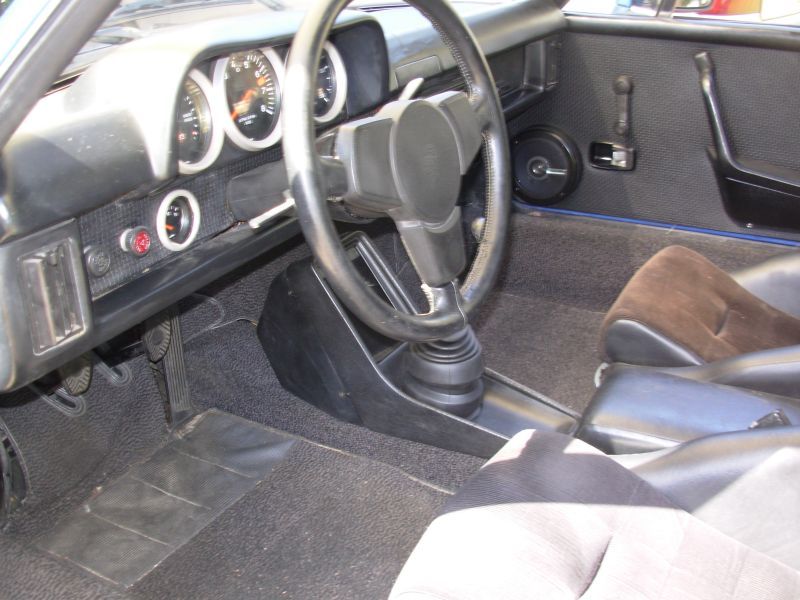

The shifter I think will definetly look better without the console, re-locate the gauges perhaps in the stock cluster gauges. Haven't had anytime to look closely at the shift box yet...would be nice to re-style it to look period correct, or drop it's height a bit. The 930 boot might work if I do some customizing...I would want to to keep the gear visible gear selection.

kg6dxn   Awesome! Take some pics from the under side. I...   Dec 7 2009, 08:58 PM
computers4kids   Ok...crawled under the car tonight and took some p...   Dec 7 2009, 11:00 PM
oldschool   it looks like you cable (pos) is hitting the trans...   Dec 9 2009, 12:10 AM
TC 914-8   Hey Mark, Looks Good. I wonder what knid of torque...   Dec 7 2009, 11:40 PM
tracks914   Hey Mark, Looks Good. I wonder what knid of torqu...   Dec 8 2009, 07:31 PM

Dr Evil   It looks like the selector cable sheath is resting...   Dec 8 2009, 12:50 AM

Dr Evil   :agree: Fix that before putting a battery in or yo...   Dec 9 2009, 12:16 AM
computers4kids   :agree: Fix that before putting a battery in or y...   Dec 9 2009, 07:37 PM

computers4kids   I decided to go ahead and clean-up the look of the...   Dec 12 2009, 04:12 PM

computers4kids   After not being able to find a suitable shifter re...   Dec 25 2009, 12:04 AM
kg6dxn   Looks much better. I like it!   Dec 25 2009, 12:22 AM
JRust   Very nicely done Mark. That looks much better. Sti...   Dec 25 2009, 01:30 PM
computers4kids   Very nicely done Mark. That looks much better. St...   Dec 25 2009, 02:42 PM
