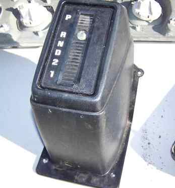

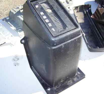

I found the shifter that was used in this conversion. It comes from Vanagons or Westfalias in the 80s.

computers4kids   I decided to go ahead and clean-up the look of the...   Dec 12 2009, 04:12 PM
Rico Suave   Why don't you have an uphostery shop make a le...   Dec 12 2009, 08:21 PM

jaxdream   Dude , I think you may be able to find a shifter s...   Dec 13 2009, 11:49 AM
kg6dxn   I bet a B&M ratchet shifter would fit in there...   Dec 13 2009, 07:14 PM
computers4kids   After not being able to find a suitable shifter re...   Dec 25 2009, 12:04 AM
kg6dxn   Looks much better. I like it!   Dec 25 2009, 12:22 AM
JRust   Very nicely done Mark. That looks much better. Sti...   Dec 25 2009, 01:30 PM
computers4kids   Very nicely done Mark. That looks much better. St...   Dec 25 2009, 02:42 PM
Rand   hesitate losing the gear selector--it's part ...   Dec 25 2009, 09:52 PM

computers4kids   I finally had some time this week to completely gi...   Mar 18 2010, 10:26 PM
Andyrew   Looks fantastic!!!   Mar 18 2010, 10:29 PM
markb   Nice job, Mark!   Mar 18 2010, 10:39 PM
Coy   That interior looks great!   Mar 20 2010, 12:04 PM
messix   please throw that plastic thing in the garbage. t...   Mar 20 2010, 12:23 PM
computers4kids   please throw that plastic thing in the garbage. ...   Apr 4 2010, 06:32 PM
kwales   That new shifter looks great. A smaller plastic...   Mar 20 2010, 04:49 PM
Jacob   That shifter looks so much better!   Mar 20 2010, 05:16 PM
Rand   Oh man, SOOOO much better, but yet just not quite ...   Mar 20 2010, 09:22 PM
