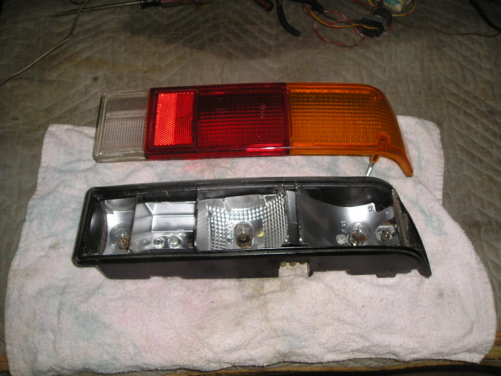

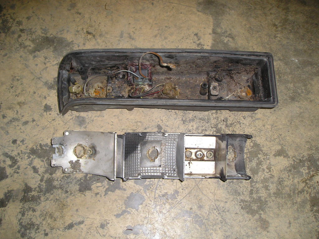

I started restoring a set of good taillights I had lying around. I finished up the passenger side and installed it. The old one was badly cracked all over and being held together by the gasket. (IMG:style_emoticons/default/huh.gif)
Before work
After I painted the innards and the housing. I cleaned all the contacts and installed a new gasket between the lens and housing.
Finished

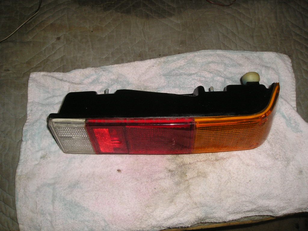

dlee6204   I started restoring a set of good taillights I had...   Dec 10 2009, 01:41 PM
