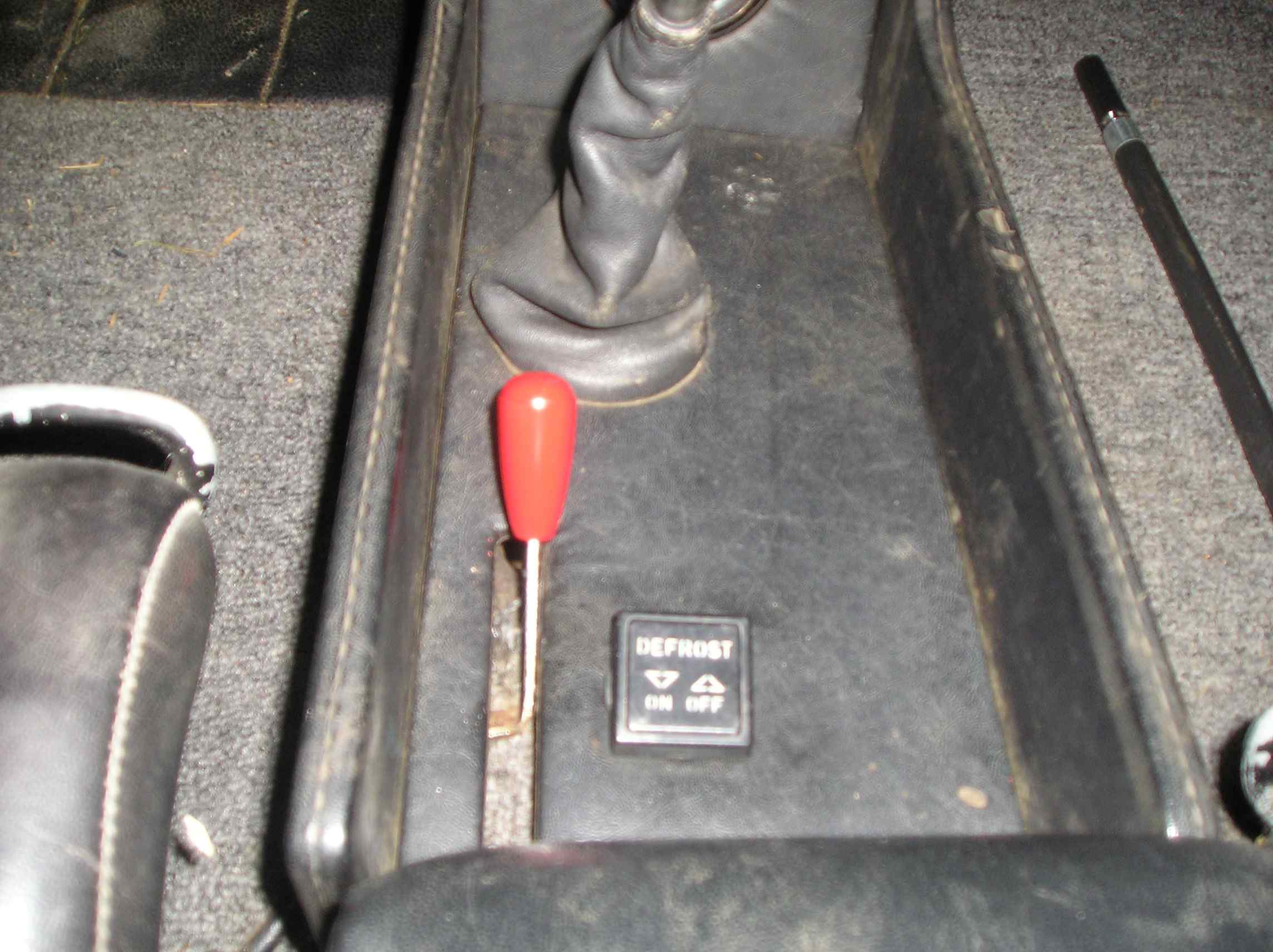

And sometimes its the small things that bring satisfaction. I painted my heater level knob (IMG:style_emoticons/default/biggrin.gif) Last weekend I also got the illumination for the heater knob working too!
