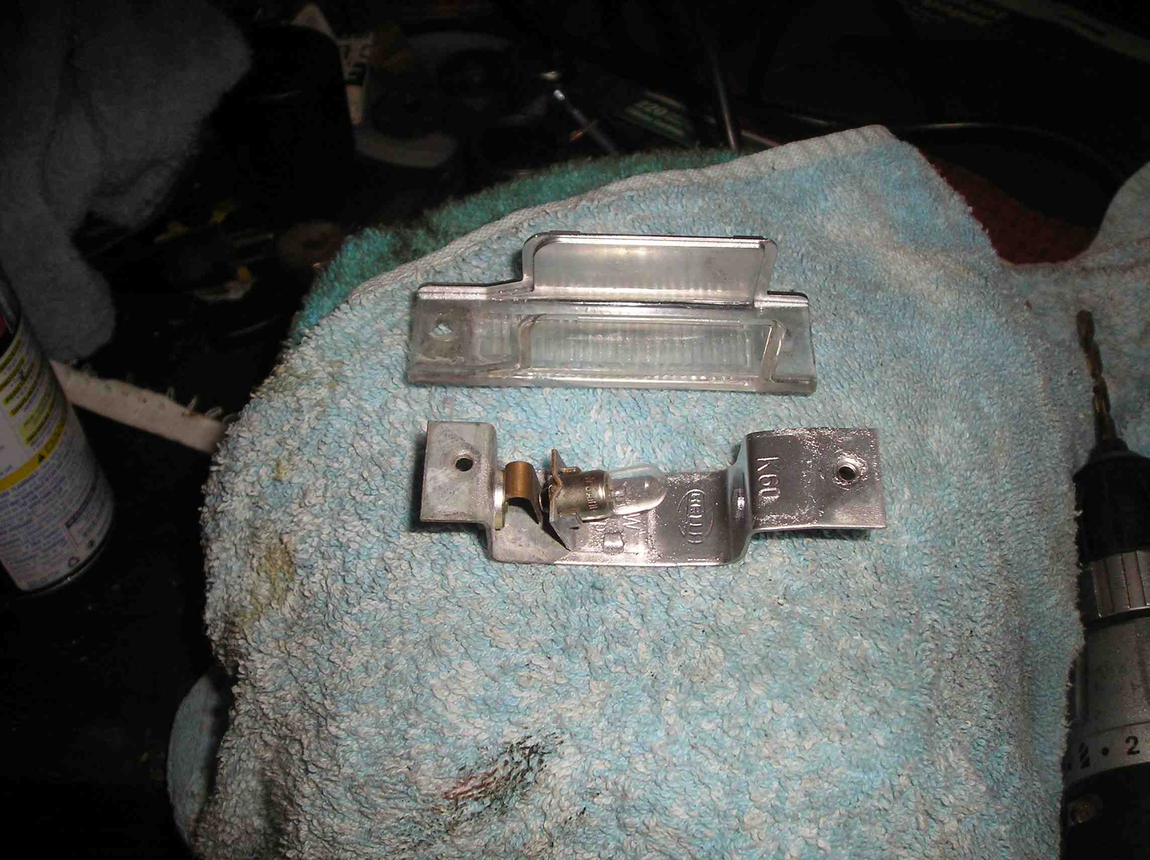

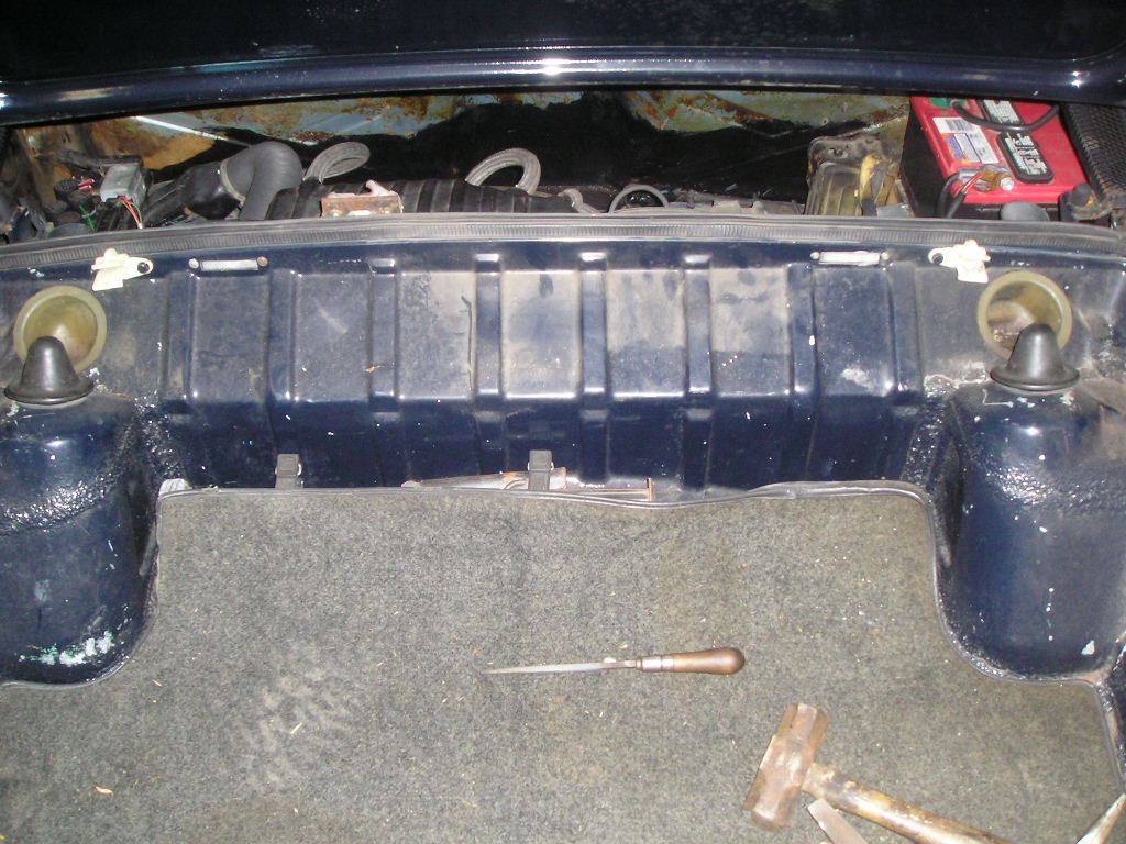

dlee6204   I did some work in the rear trunk. At some point ...   Dec 10 2009, 01:48 PM
dlee6204   And I did a little "upgrade" to the rear...   Dec 10 2009, 01:56 PM
