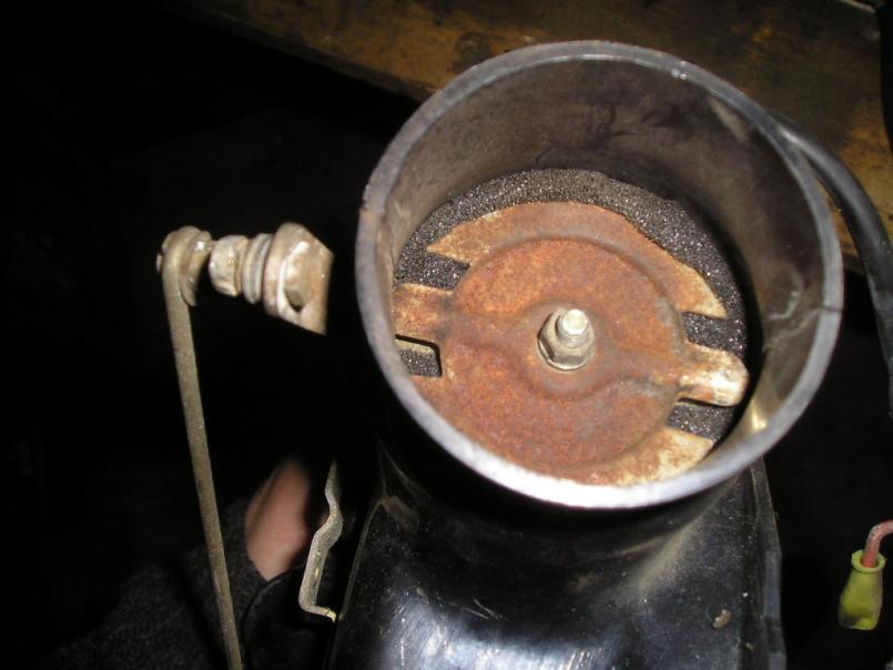

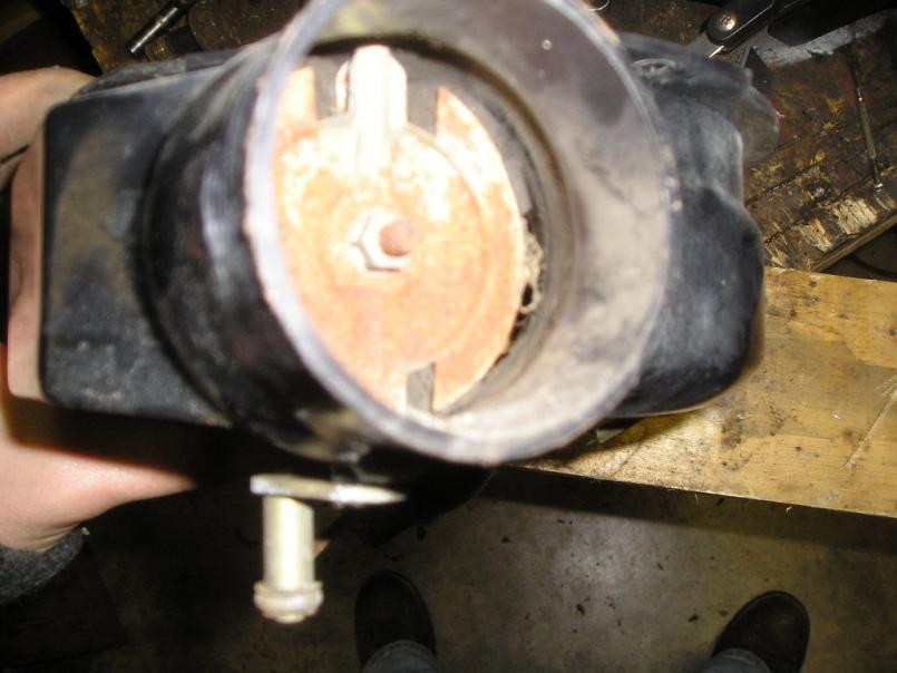

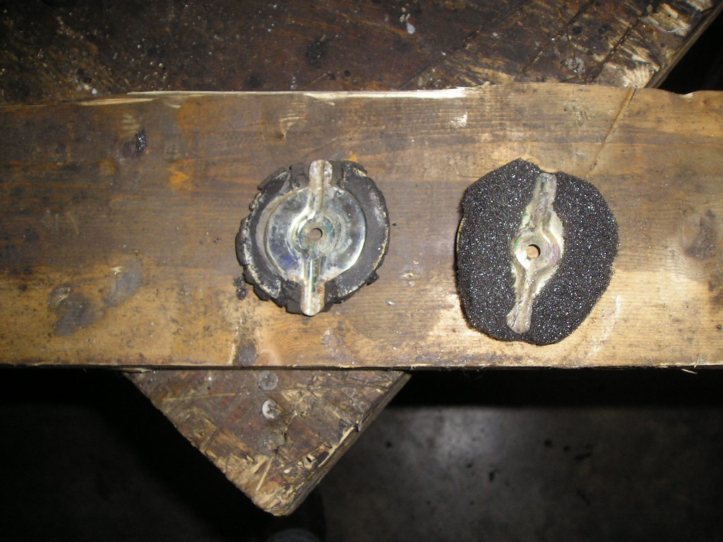

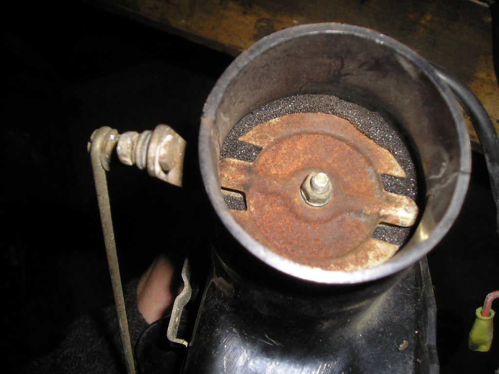

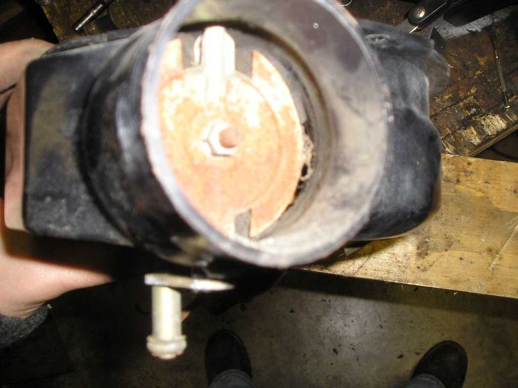

Currently the fresh air fan doesn't work so I plan on replacing it. I pulled a good working unit off a parts car and did a little work to it. First, the gaskets on the opening/closing valves were completely toast. With the fan on and valves closed, there was an ample amount of air coming out of the ducting. To fix this, I replaced these foam gaskets with a new foam ring that I cut out of a 1/4" sheet of foam we had lying around. Now, the valves keep out the air when they are in the closed position.
Here is a picture of the old gaskets in place. You can see where part of it was missing around the edge.
Here is the new gasket I made compared to the old one.
And here it is in the ducting.
