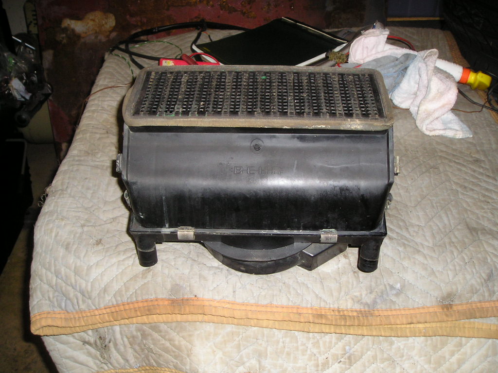

dlee6204
post Dec 11 2009, 10:14 PM
Howdy
Posts: 2,162
Joined: 30-April 06
From: Burnsville, NC
Member No.: 5,956
Here is the fan assembly ready to be installed in the car.
I'm starting to have a pile of parts building up. (IMG:style_emoticons/default/biggrin.gif) I need to start installing them on my car!
