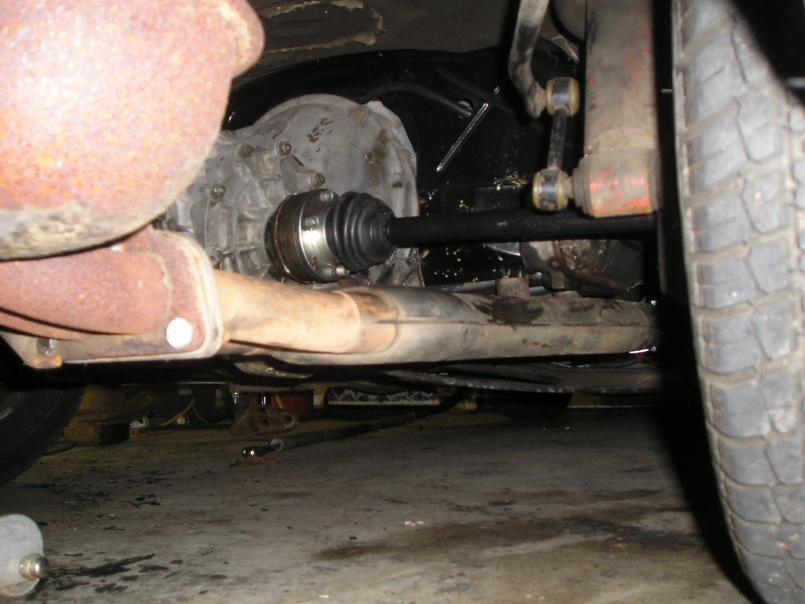

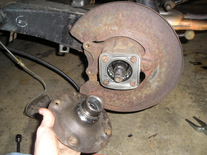

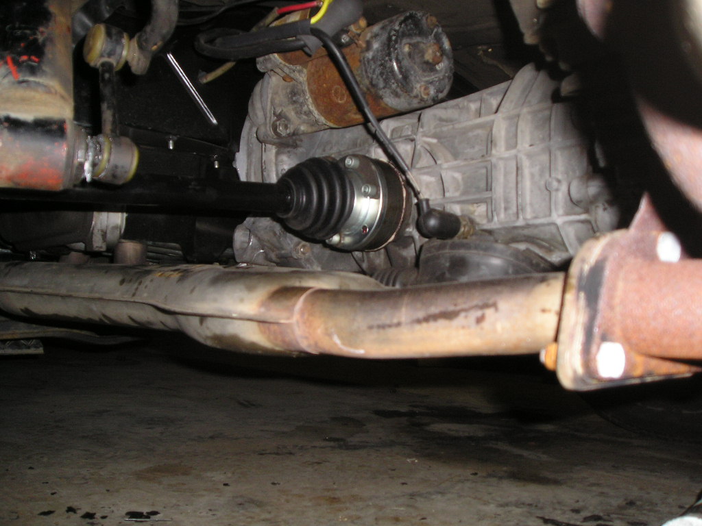

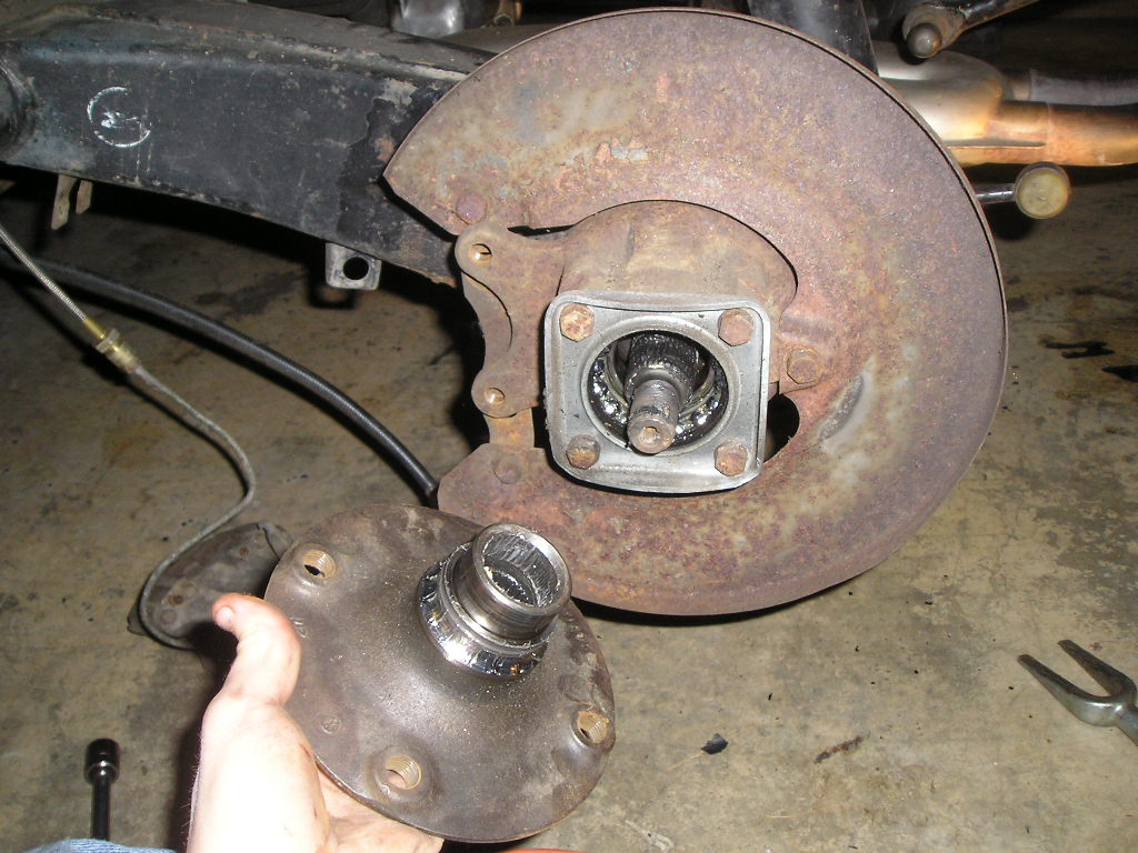

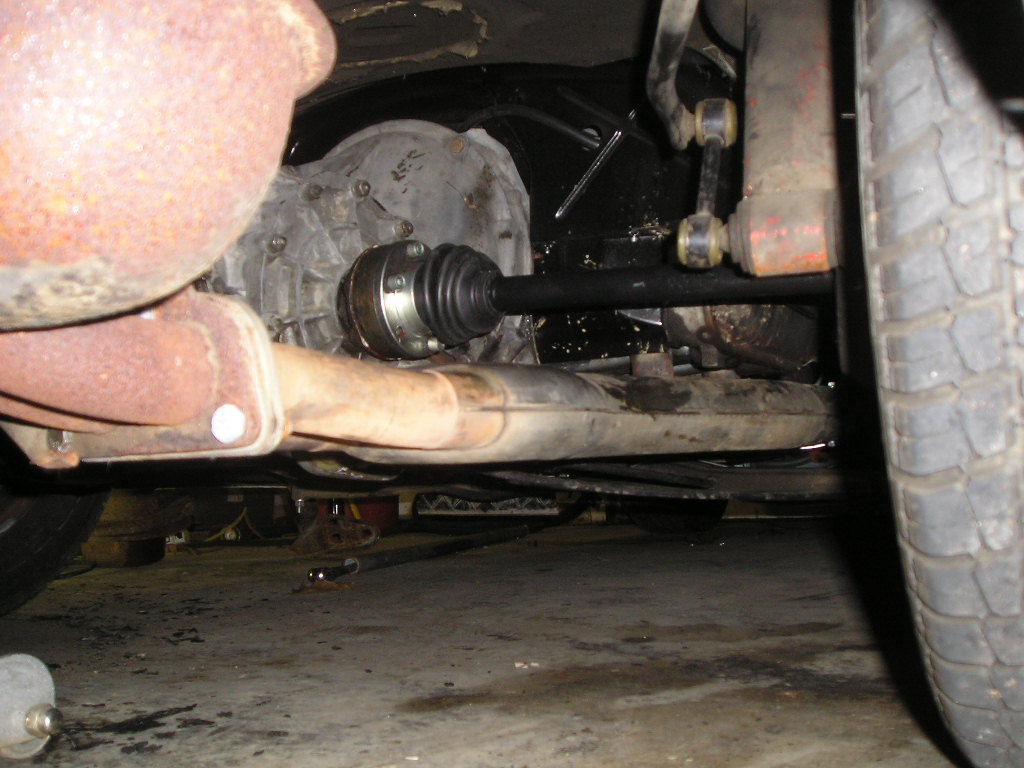

I moved onto the rear end. Recently I've been having a progressive noise coming from the driver's side rear so I wanted to figure out why. I also wanted to fix the negative camber issue and replace the driveshafts while I was in there. After taking off the caliper and rotor, I notice the hub was way too loose in the bearing. I was able to wiggle it back and forth and then it popped out! (IMG:style_emoticons/default/WTF.gif) (I previously replaced this bearing.)
I figured that was the source of the noise so I moved onto the camber issue. I replaced the trailing arm with a spare and it still had too much negative camber so I knew it wasn't a bent trailing arm. I ended up putting in approximately 1 cm of spacers to solve the camber issue. I also put in a new wheel bearing (a different brand than the first) in the second trailing arm so now I should be good to go. The driveshafts were replaced in the process.
