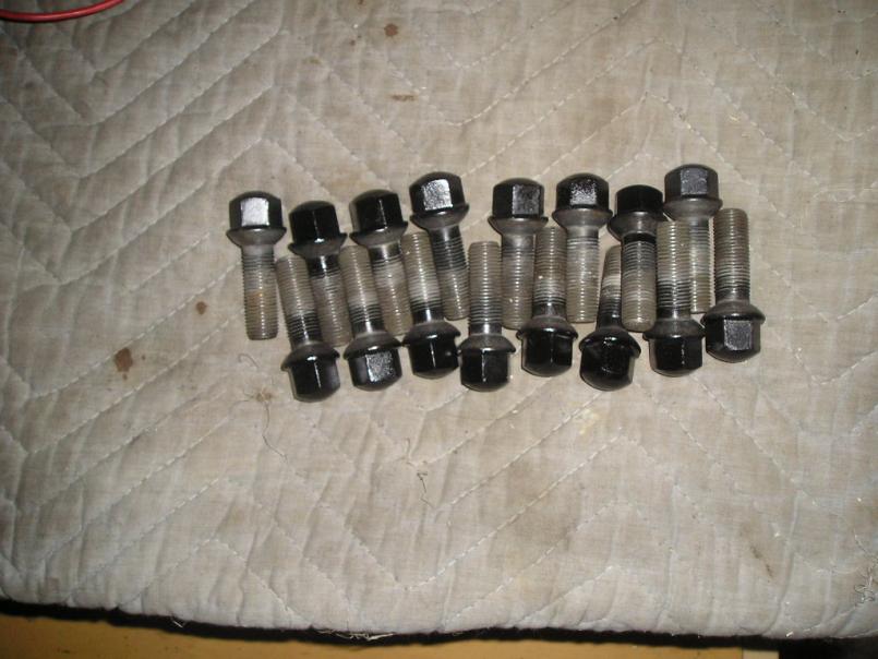

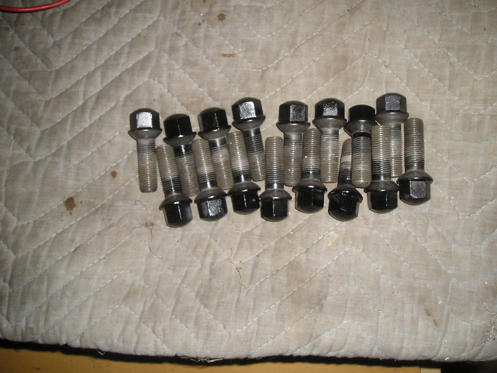

Hopefully you guys don't think thats ALL I did this weekend (IMG:style_emoticons/default/biggrin.gif) I painted my lugnuts to match the wheels.

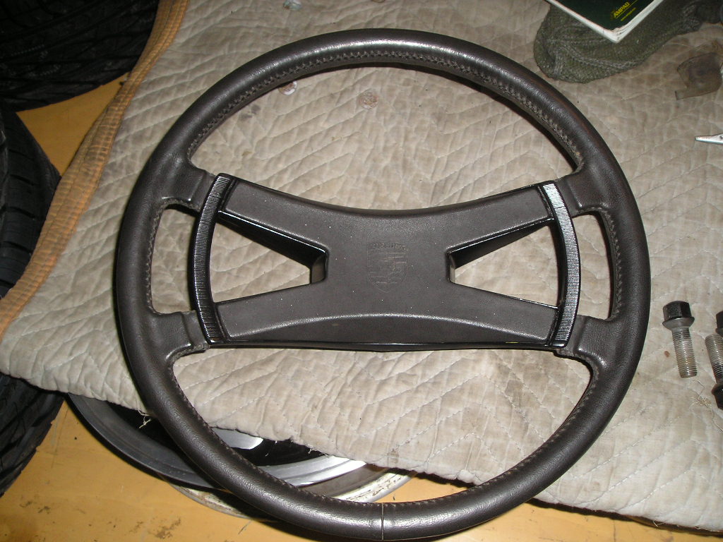

When searching through the loads of parts we have around here I found an original leather steering wheel. SAWEET. I cleaned up the wheel, painted the metal horn button part, and re-glued the horn pad. I think I will install this on my car and sell the old one.
