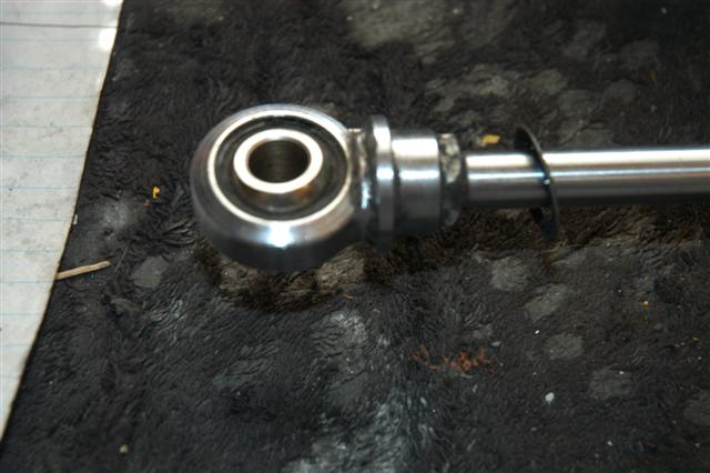

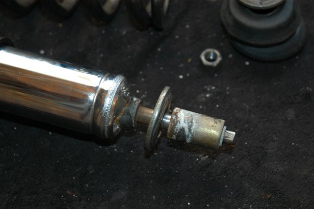

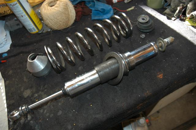

Joe Ricard   Chris I just love the way you fixed the rear shoc...   Dec 13 2009, 05:19 PM
Racer Chris   They machined nicely. I used my old worn out P...   Dec 13 2009, 06:19 PM
