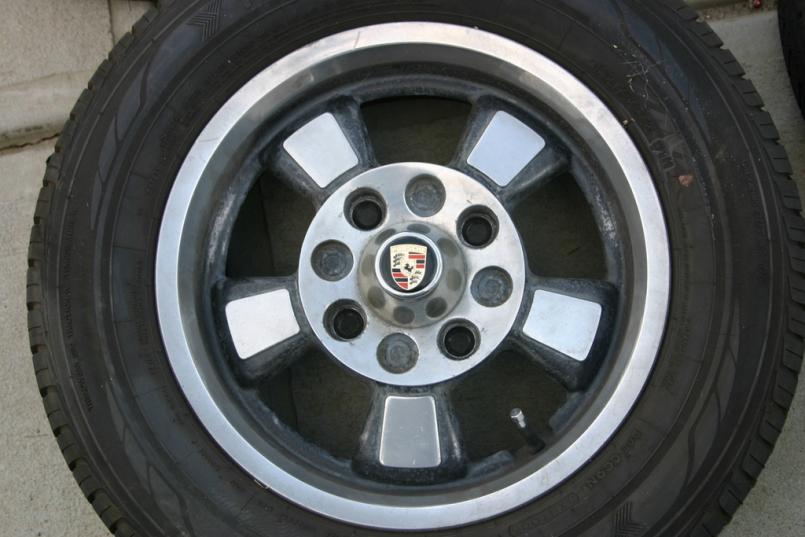

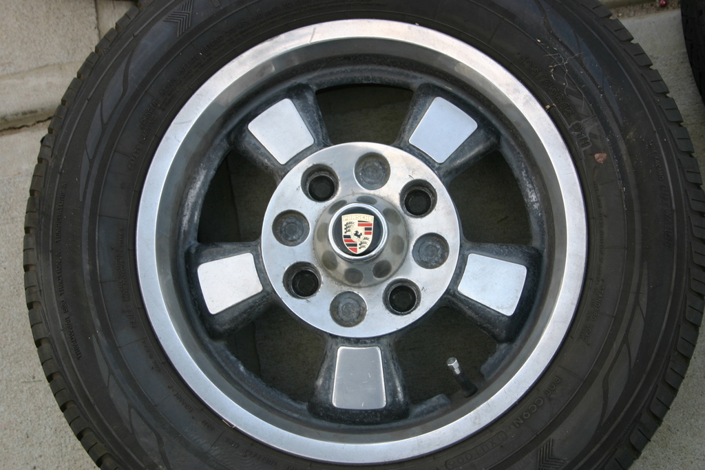

Sweetness John! Good to hear you got it running again.
You know I've got an extra set of shoes over here if you want to get away from the steelies. Lots of Yokahama rubber on them.
