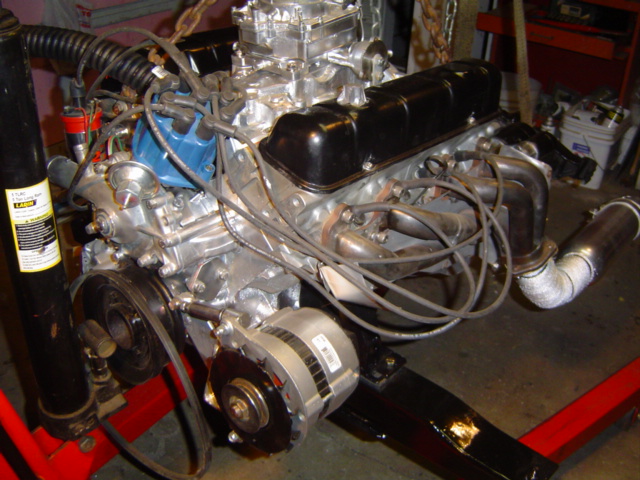

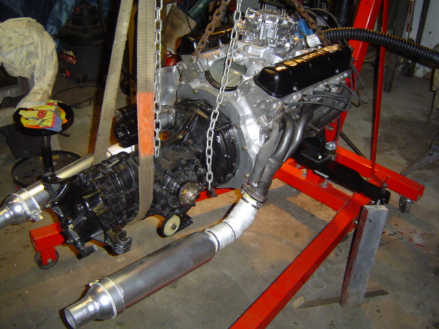

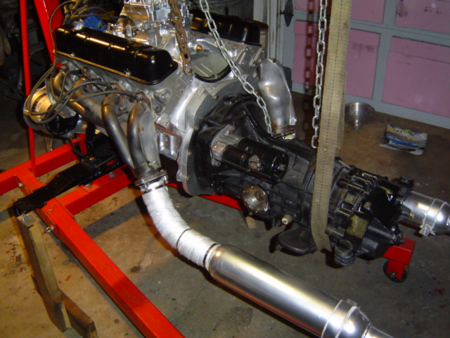

Here's my version, alternator relocated down low. Now it clears the firewall but runs into the brake proportioning valve. Always something.
Exhausts fabbed out of 4"x18" garden variety mufflers off ebay.
ran out of space. See next post

Cheapsnake   Here's my version, alternator relocated down l...   Dec 24 2009, 04:55 PM
Cheapsnake   continued... Water pump is just an empty shell. ...   Dec 24 2009, 05:17 PM
