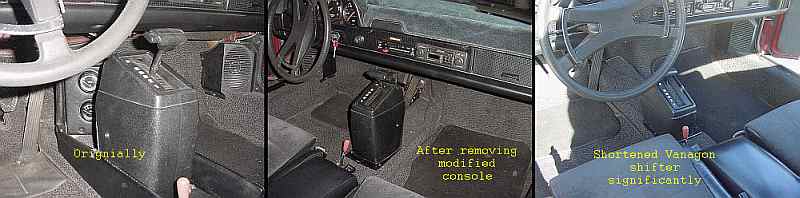

I just couldn't resist....when I saw this car come up for sale by the owner who has had it for the last 8 years, I had to buy it. When the second owner's, husband passed, the surving wife drove the car for years. As she could no longer continue to manage a clutch car, she paid a Porsche shop to convert it to an automatic using an Audi transmission.
After receiving pictures from the owner, I couldn't believe how nice the the car was for the price. It wasn't until I went to see it was I shocked at the professional job the shop did converting it to an automatic. Other than the shift mechanism in the car the rest of it looks like it belongs. I'll have to massage the shifter look in the car, but other than that. I'm not to sure what I'm going to do with the car, but for now fix the little rust and drive it?? (IMG:style_emoticons/default/confused24.gif)

After not being able to find a suitable shifter replacement, I decided to redesign the tall vanagon one that was used. I literally took a good 7 inches off the old shifter. I took several inches off the middle of the bracket and some off the extension rod. It actually was more difficult than I first thought, especially keeping the geometry and throw the same. Anyway, good for now.
I had called Jeggs and it turns out that all the generic shifters they sell, i.e Hurst, B&M are made for American cars and transmissions. (IMG:style_emoticons/default/sad.gif)

computers4kids   After not being able to find a suitable shifter re...   Dec 25 2009, 12:04 AM
kg6dxn   Looks much better. I like it!   Dec 25 2009, 12:22 AM
JRust   Very nicely done Mark. That looks much better. Sti...   Dec 25 2009, 01:30 PM
