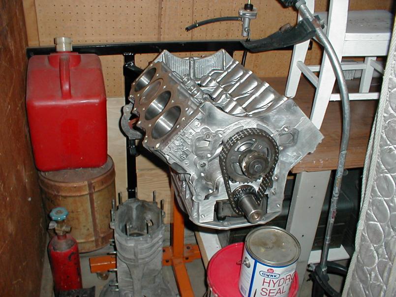

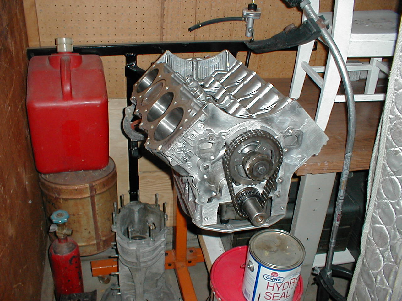

codices
post Dec 24 2009, 03:53 PM
Posts: 95
Joined: 9-October 08
From: Morrison, Colorado
Member No.: 9,626
I will attempt to post a picture of the cradle. It is against the wall behind the engine.
streetrover
post Dec 26 2009, 10:37 AM
Posts: 87
Joined: 22-December 09
From: Inland Empire
Member No.: 11,163
That sure is a clean motor!
