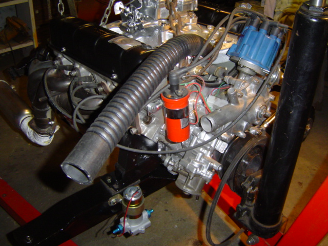

continued...
Water pump is just an empty shell. Without the wp pulley, now it's easy to see that the distributor becomes the forwardmost problem. I'm going to seriously consider the megajolt jr. to get rid of it. I love those headers, they're off a 4.0, all stainless and heat shielded.

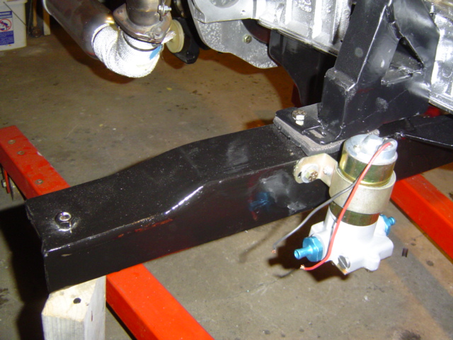

Shot of the engine mount and cradle, all handmade, about 20 hours of work. If you can find something off the shelf, take it!

It may have taken awhile, but that crossmount looks sweet!

QUOTE(streetrover @ Dec 26 2009, 08:41 AM) *
Thanks, if you can't find anything off the shelf you may be doing the same. I'll take some dimensions off the xmember before I drop it in, which will give you a head start on the job if you end up doing it yourself. How's your metalworking and welding skills? I like the looks of your engine mounts and would definitely build around them, if possible. I built in about 1 1/2" of fore and aft adjustment which will enable me to snug it up as close as possible to the firewall.
