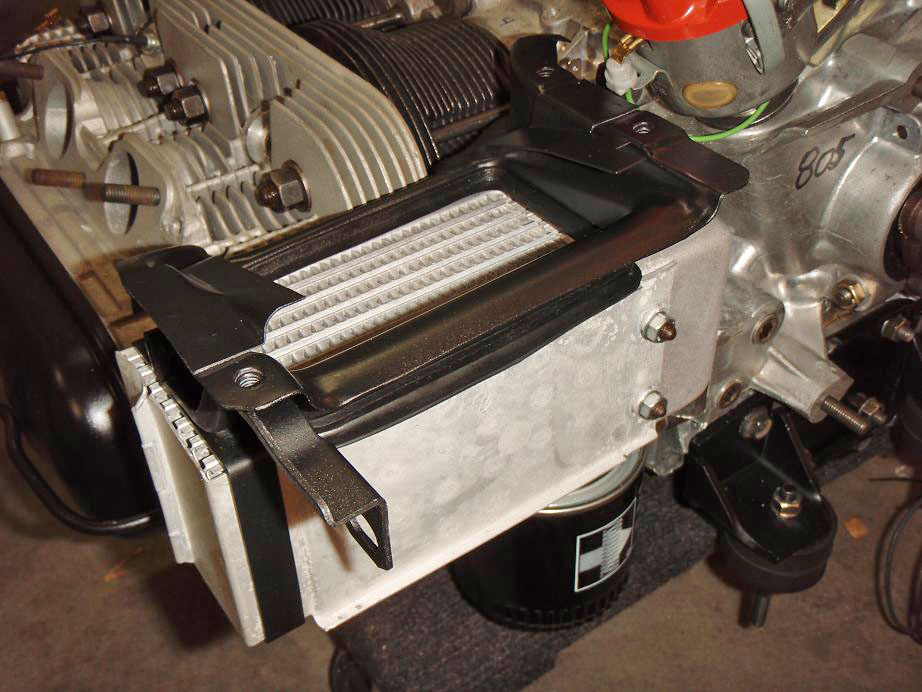

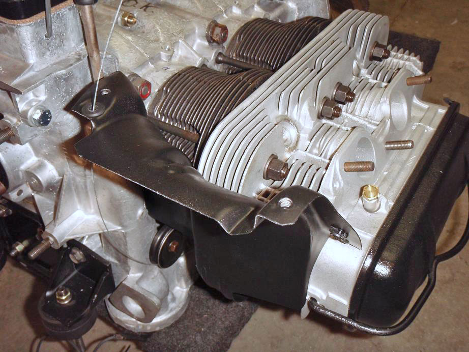

The engine is off the stand and tin and FI components are being added. I had the top tins powder coated. All the rest I painted with high temp paint.
Front side tins went on first.
