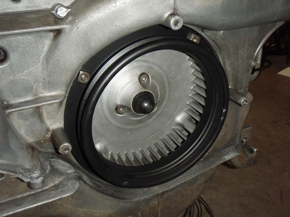

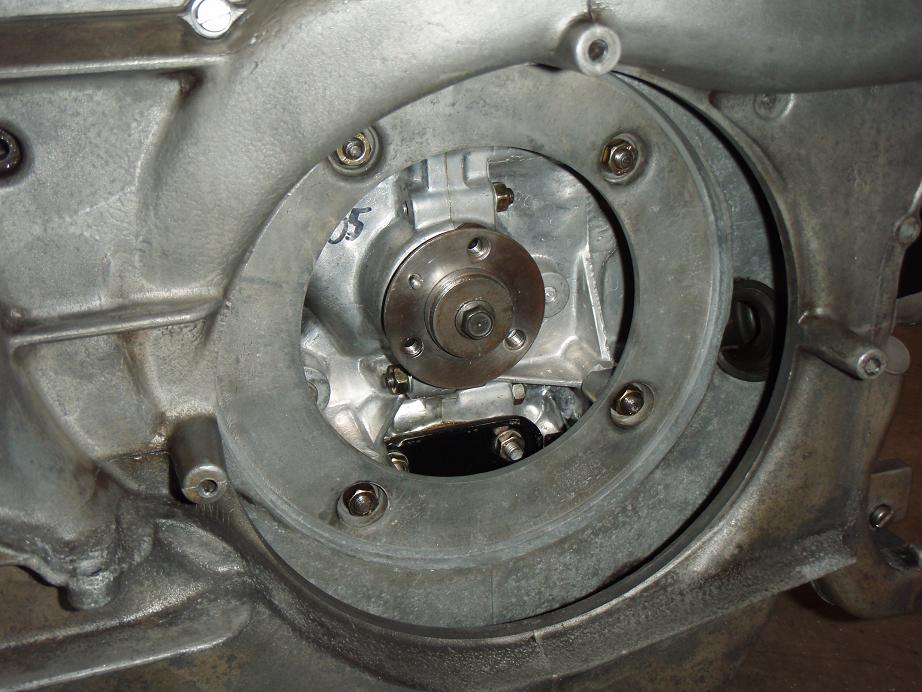

Then the fan shroud and fan.
You may want to temporarily tape the front passenger tin in place. There's nothing holding it in place until the top tins go on. It fell off after I put the shroud on. It found its way off, but I couldn't get it back into place without removing the shroud.

MrKona   Then the fan shroud and fan. You may want to temp...   Dec 27 2009, 08:03 PM

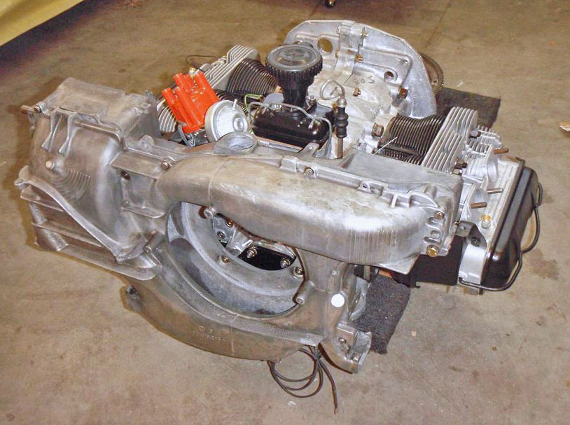

MrKona   An update of the latest status of my engine rebuil...   Apr 18 2010, 10:28 PM
MrKona   A couple more shots of the engine before it goes i...   Apr 18 2010, 10:30 PM
