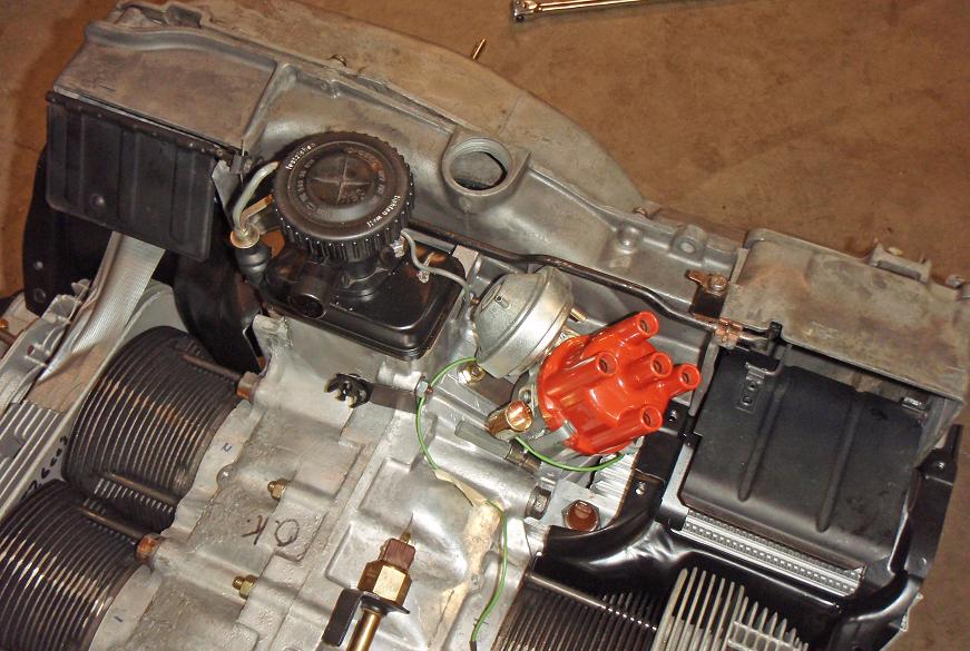

MrKona   The engine is off the stand and tin and FI compone...   Dec 27 2009, 08:01 PM

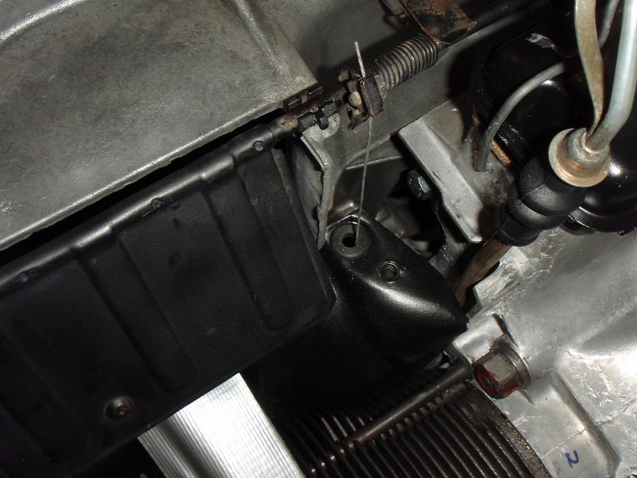

MrKona   Then I attached the cooling flaps and thermostat c...   Dec 27 2009, 08:11 PM
MrKona   And then the top tins! I had to remove the dis...   Dec 27 2009, 08:16 PM
