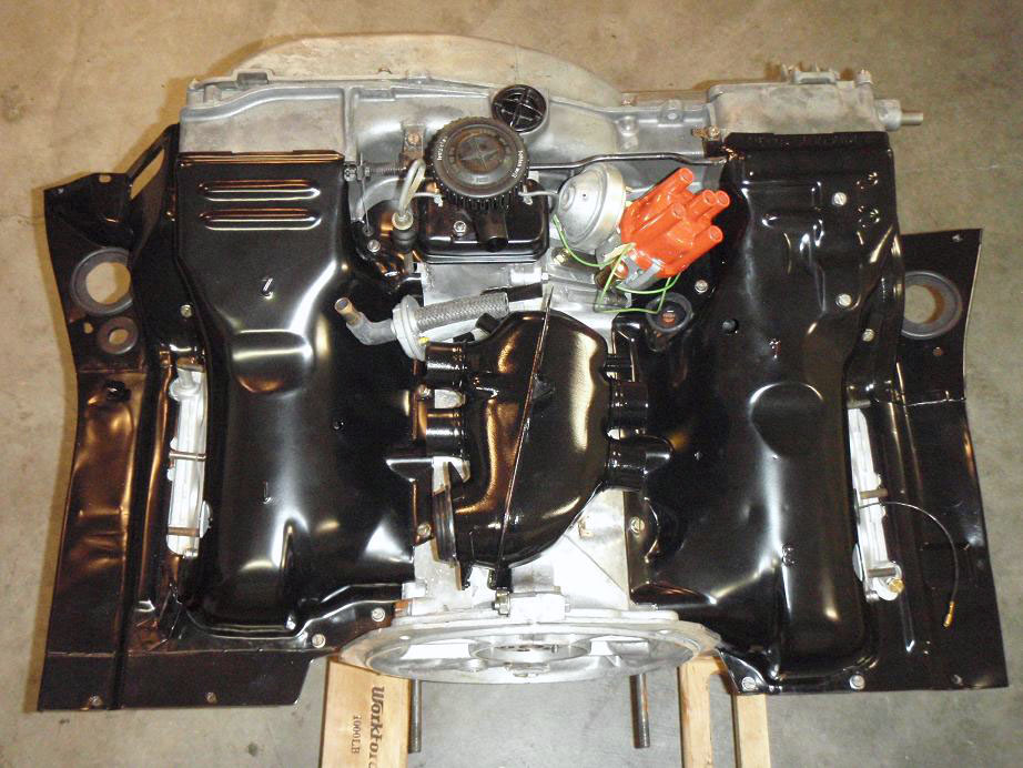

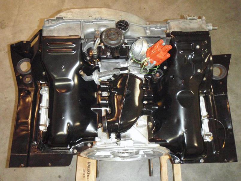

And then the top tins! I had to remove the distributor to place the right side tin.
Also started adding some FI components. My plan is to use the original L-jet components, just adding a set of 2.0 intake tubes which are drilled for the 3-stud cylinder heads...

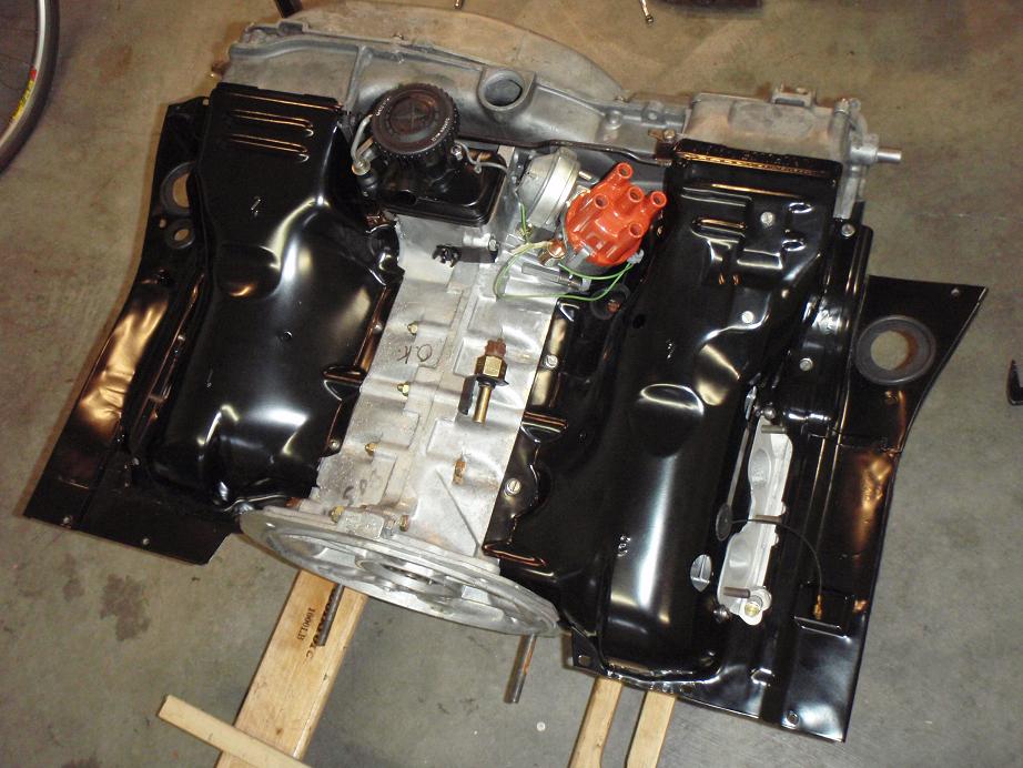

MrKona   The engine is off the stand and tin and FI compone...   Dec 27 2009, 08:01 PM
MrKona   Then the fan shroud and fan. You may want to temp...   Dec 27 2009, 08:03 PM
MrKona   Then I attached the cooling flaps and thermostat c...   Dec 27 2009, 08:11 PM
MrKona   And then the top tins! I had to remove the dis...   Dec 27 2009, 08:16 PM

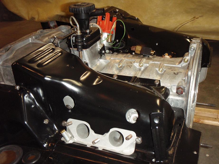

MrKona   And this is where my momentum stopped... I acquire...   Dec 27 2009, 08:19 PM
MrKona   But they don't fit the intake housing! :a...   Dec 27 2009, 08:23 PM
