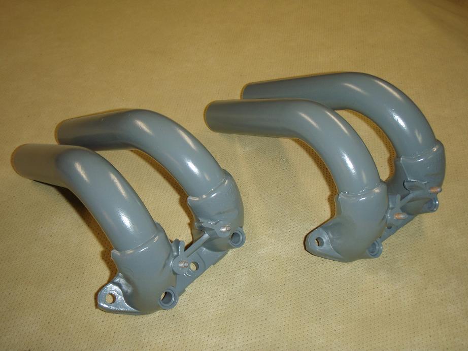

And this is where my momentum stopped... I acquired a set of 2.0 3-stud intake tubes. Had them cleaned, then I painted them in gray similar to the factory tubes to make them all pretty...

MrKona   But they don't fit the intake housing! :a...   Dec 27 2009, 08:23 PM
