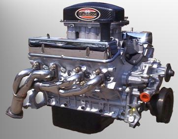

Bob,
That "accordian" is probably for a problem that Rover found in different rates of expansion between the aluminum heads and the tubular steel header. RPI in Great Britain indicates that these tubular headers (with the heatshields) are stainless steel. Cast iron will be quieter (so I'm told) but they are heavier. The photo shows those headers polished.
