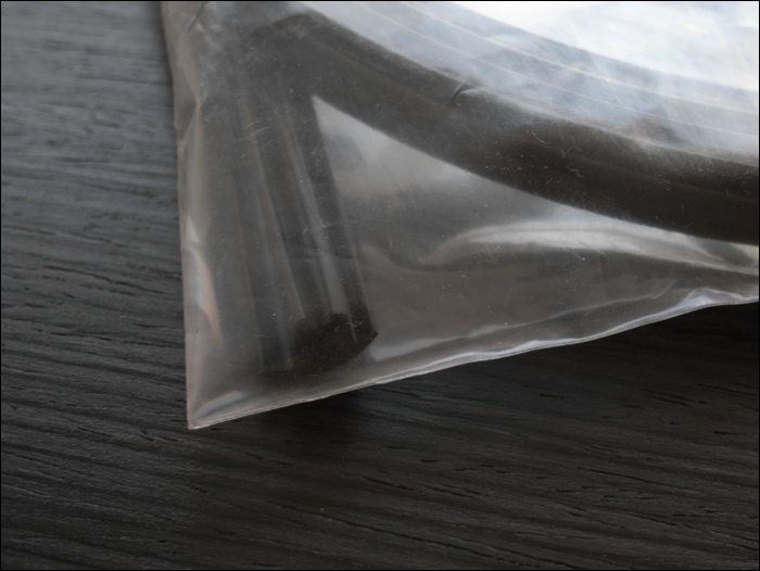

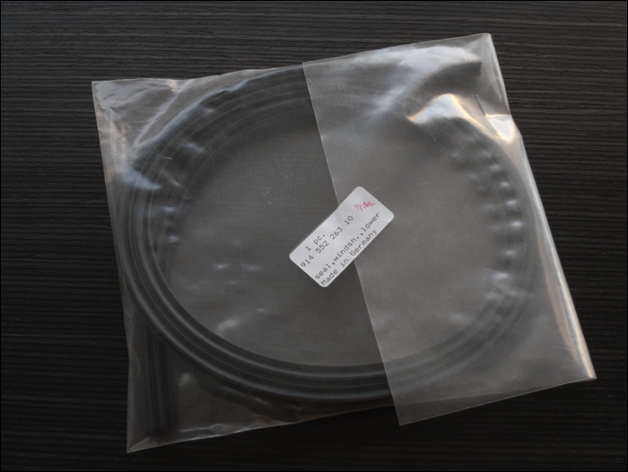

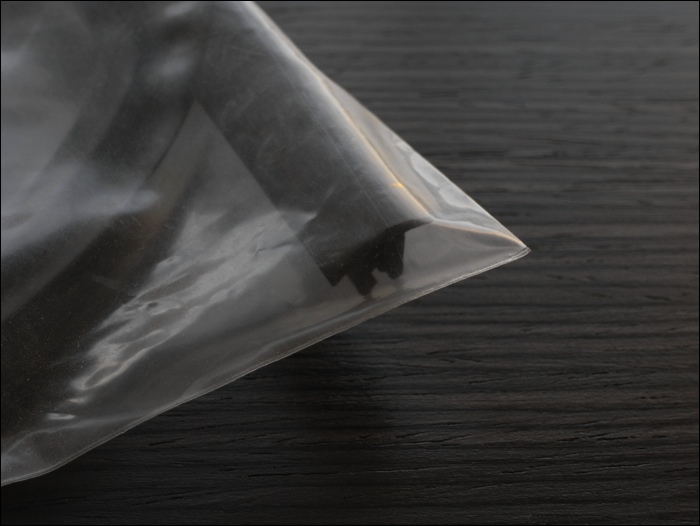

Terry, I bought a couple dash-to-windshield beads from Stoddard a year or 2 ago. Price each was either $108 or $128, I forget which. The couple of aftermarket offerings I've seen have all been too wide, which doesn't look right to me (and require trimming around the defrost vents). Stoddard's appears to be the same width as OEM, though I haven't measured to confirm. No metal to rust; design appears to be good without gluing, so should be easily saved if/when you need a new windshield in the future. As you can tell from the pix, I haven't installed yet (waiting on the silver car), so this is all I know.
George, is the seal below the same design as the late factory one? Is yours similar? Better? Correct width? Cost? Thanks in advance! (I'll snap a close-up photo, unwrapped from the plastic, later - camera ran out of juice and is charging.) Attached image(s)

The last of the stoddards were actually aftermarket made in Germany but with no metal in it. The configuration was correct yes. Aftermarket have a bit more material actually to cover the dash vinyl a bit better. They also lack the metal so both are a glue in.

number6 Close up of the Stoddard dash-to-windshield bead. Jan 18 2010, 08:23 PM![]() ![]() |
