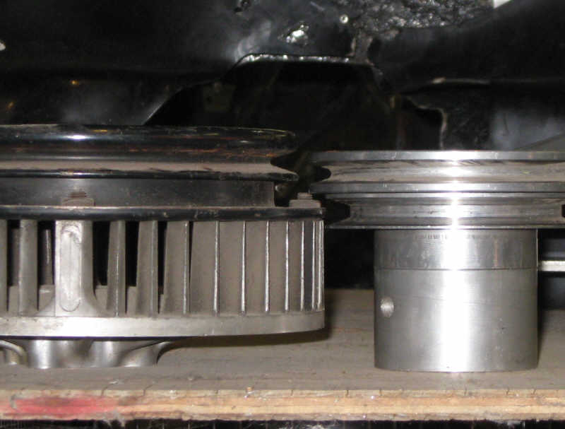

With the necessarily high tension on the belts at the end of that long extension on the end of the crank, how's the side loading on both the snout of the crank and the #4 main bearing?

The tension isn't any higher than any alternator belt.
Not only that, my pulley isn't as far away from the #4 bearing as the factory pulley.
