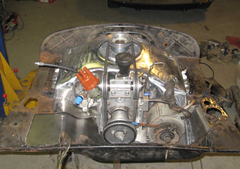

This prototype will be ready for installation in my street car in a few days.
(IMG:http://www.tangerineracing.com/images/EnginePics/TangerineEngineCoolingSystemPrototype01.jpg)
(IMG:http://www.tangerineracing.com/images/EnginePics/TangerineEngineCoolingSystemPrototype02.jpg)

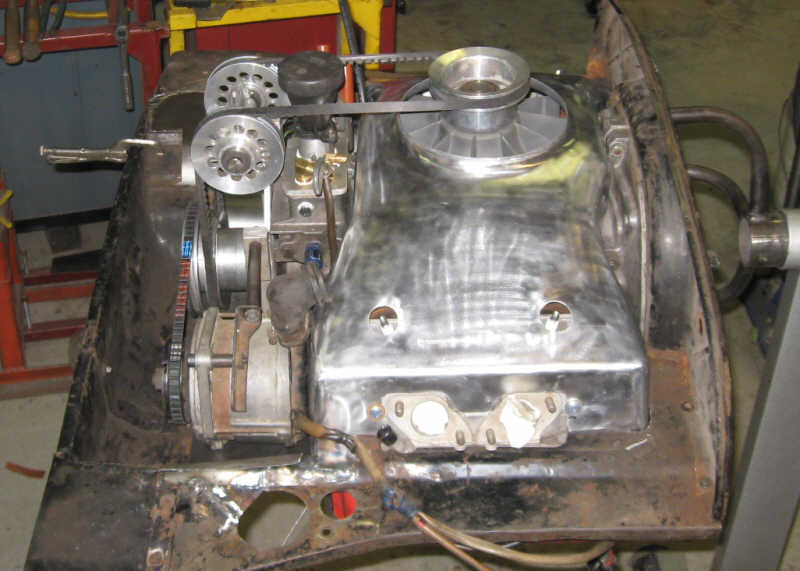

Here are pics of the latest progress.

jaxdream   Does look good :Qarl: :headbanger: , alternator c...   Jan 21 2010, 09:12 AM
Racer Chris   What about alternator cooling ?? Oil filter appea...   Jan 21 2010, 02:10 PM
ottox914   What about alternator cooling ?? Oil filter appe...   Jan 21 2010, 06:13 PM
Racer Chris   - Would changing the alternator out to a more mod...   Jan 21 2010, 08:31 PM
Mr.242   I like the enginering...very Corvair ISH. NOW, wh...   Jan 21 2010, 09:17 AM
SirAndy   NOW, what about just adding an electric fan on to...   Jan 21 2010, 01:37 PM

Cap'n Krusty   With the necessarily high tension on the belts at ...   Jan 21 2010, 09:58 AM
Racer Chris   With the necessarily high tension on the belts at...   Jan 21 2010, 02:04 PM

flipb   If you reverse the direction of the fan, would you...   Jan 21 2010, 02:15 PM
URY914   And the belts are much better these days then in y...   Jan 21 2010, 03:25 PM

URY914   Chris, is the aluminum several pieces you tig...   Jan 24 2010, 07:37 PM
Racer Chris   Chris, is the aluminum several pieces you tig...   Jan 25 2010, 05:55 AM
Dr Evil   Bang on corvair as it is belt driven vs gear drive...   Jan 24 2010, 10:07 PM

rdauenhauer   I was wondering about this..It dosent look like t...   Jan 25 2010, 08:46 AM
Racer Chris   I was wondering about this..It dosent look like t...   Jan 26 2010, 08:07 PM

Racer Chris   I'm working on a wooden buck to form more alum...   Feb 16 2010, 12:21 PM

Racer Chris   Here's an Audi TT intercooler sitting on my th...   Feb 24 2010, 12:16 PM
Racer Chris   And here's a pic of the wooden form I've b...   Feb 24 2010, 12:23 PM

Racer Chris   How did you make the wooden buck? Belt sander? I...   Feb 24 2010, 04:45 PM
