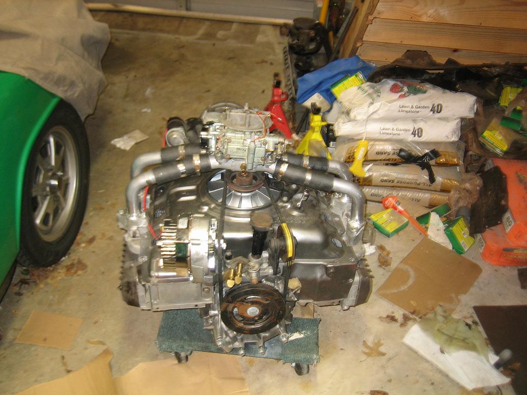

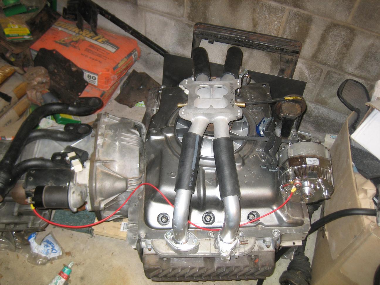

This prototype will be ready for installation in my street car in a few days.
(IMG:http://www.tangerineracing.com/images/EnginePics/TangerineEngineCoolingSystemPrototype01.jpg)
(IMG:http://www.tangerineracing.com/images/EnginePics/TangerineEngineCoolingSystemPrototype02.jpg)

Bang on corvair as it is belt driven vs gear driven. Very cool and proven on 6cyl vair motors.
The tension on the belts is not very much. The main reason for throwing belts is having the belts too tight. The vair fans are very light and out of mag alloy so that they do not fight RPM changes. The vair setup does have belt protectors near the pulley and the fan pulley. The alt is set in as one of the 90* pulleys. Here are some pics of mine. Good setup.
