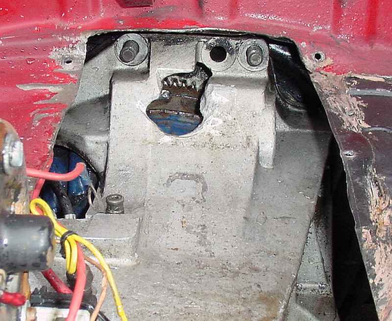

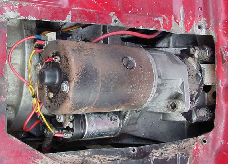

I decided to pull the black cover in the trunk today which is where the starter is located at 12:00. Normally there is no starter normally located at 12:00, but the only location that would work in a 914/4--Audi transaxle conversion. I was curious if I could learn more how they made the starter work.

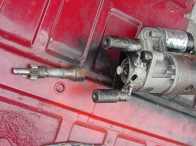

As you can see a "stock 914" starter was used. It was bolted to an adapter that looks like it was custom made. The starter connects to the adapter and the adapter bolts to the adapter plate mated to the 914 motor.

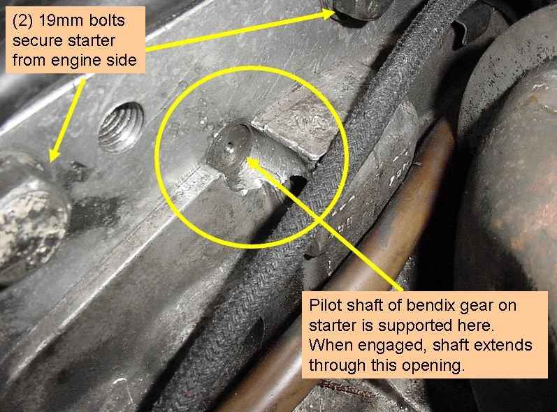

Here you can see the two 19mm bolts that secure the starter from the back side of the adapter plate (engine compartment). You can also see the shaft of the bendix gear rides on protruding through part of the adapter plate and part of the edge of the 914 case.
An hole was opened-up on the top side of the transmission to expose the teeth on the torque converter. You can see the two bolts that secure the starter. You can't see the bendix shaft hole. If you look at 10:00, you'll see where the starter is normally on this Audi 5000 application.

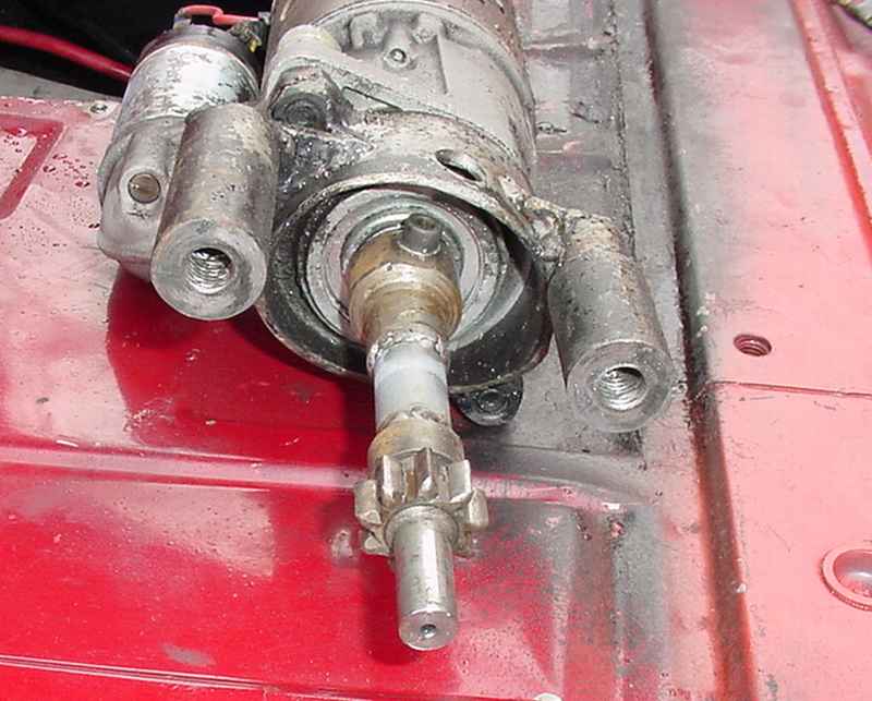

These next two pictures show how an extension was made to space the bendix gear at the right distance so to engage the torque converter teeth properly. You'll also notice the teeth on the bendix gear on the 914 starter is different than the end that meets the torque converter teeth. The extension is held on by three allen bolts. A notch for each of the bolts was cut in the actual 914 bosch starter bendix gear.to lock the extension in place.

QUOTE(computers4kids @ Jan 24 2010, 08:02 PM) *
Is that a booster relay in there?

computers4kids   I decided to pull the black cover in the trunk tod...   Jan 24 2010, 10:02 PM
zx-niner   Is that a booster relay in there?   Jan 24 2010, 10:44 PM
computers4kids   Is that a booster relay in there? Hi Steve...   Jan 24 2010, 10:51 PM
rick 918-S   Very crude looking construction but I really reall...   Jan 24 2010, 10:18 PM
kg6dxn   That's not bad backyard fabrication. I bet you...   Jan 24 2010, 10:23 PM
