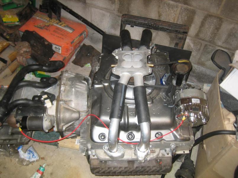

so the carbs and cooling system intake get fresh cool air from above,
I was wondering about this..It dosent look like this setup is designed to accommodate a common plenum intake?

QUOTE(rdauenhauer @ Jan 25 2010, 09:46 AM) *
You mean something like this?
I think a d-jet setup could be worked out but the stock filter housing would have to be changed out for a "cold air intake", and the runners would have to be remade to fit a raised plenum. The 1.7L plenum would be easier to work with because of the side mounted TB.
