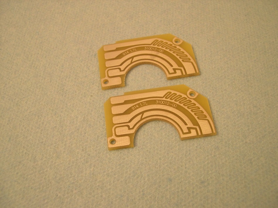

I just received the boards for the late 1.7liter cars. (Please note that these boards will not work on the early 1.7 cars. Completely different switches.) Sorry that this has taken so long. Here's a pic:

QUOTE(davesprinkle @ Jan 29 2010, 03:15 AM) *
Mines a March 1973 1.7l, would this be correct for your new tps? Mine is filthy, so If correct I would love one..
Please let me know... rodsrugs(at)me.com
davesprinkle
post Jan 29 2010, 07:12 PM
Posts: 720
Joined: 13-October 04
From: Berkeley, CA
Member No.: 2,943
QUOTE(Rod @ Jan 29 2010, 10:29 AM) *
Yes, this board will work for your car.
