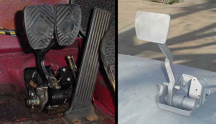

The mechanic that did the pedal cluster conversion did do a pretty nice job creating the double brake pedal, but I was pretty happy with the ebay auction that I won for $41. AutoAtlanta was selling off what look like a NOS Sportomatc pedal cluster for 914-6. Perfect! (IMG:style_emoticons/default/piratenanner.gif) I was glad to see the auction didn't get much attention. It was a gold find for me. James from Morphenspectra is going to make a carpet kit for me without the clutch pedal slot and no hole for the piece that goes over the tunnel for the shifter. All in all, it should clean up the look nicely.
Haven't decided what to do for a brake pedal pad.

computers4kids   The mechanic that did the pedal cluster conversion...   Jan 30 2010, 08:39 PM
markb   See if the pad from a VW sporto pedal will fit.   Jan 31 2010, 02:06 AM
