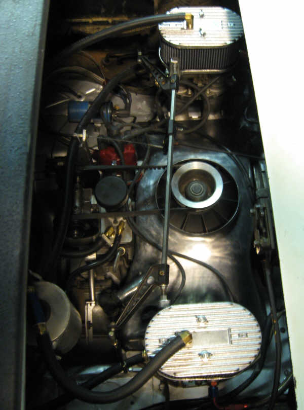

This prototype will be ready for installation in my street car in a few days.
(IMG:http://www.tangerineracing.com/images/EnginePics/TangerineEngineCoolingSystemPrototype01.jpg)
(IMG:http://www.tangerineracing.com/images/EnginePics/TangerineEngineCoolingSystemPrototype02.jpg)

Here's how it looks in the car.

jaxdream   Does look good :Qarl: :headbanger: , alternator c...   Jan 21 2010, 09:12 AM
Racer Chris   What about alternator cooling ?? Oil filter appea...   Jan 21 2010, 02:10 PM
ottox914   What about alternator cooling ?? Oil filter appe...   Jan 21 2010, 06:13 PM
Racer Chris   - Would changing the alternator out to a more mod...   Jan 21 2010, 08:31 PM

Cap'n Krusty   With the necessarily high tension on the belts at ...   Jan 21 2010, 09:58 AM
Racer Chris   With the necessarily high tension on the belts at...   Jan 21 2010, 02:04 PM

kwales   No, the electric fan isn't used for cooling, i...   Jan 21 2010, 12:10 PM
URY914   Don't think that an electric motor driven fan ...   Jan 21 2010, 12:30 PM
Racer Chris   Don't think that an electric motor driven fan...   Jan 21 2010, 02:17 PM

flipb   If you reverse the direction of the fan, would you...   Jan 21 2010, 02:15 PM

URY914   Chris, is the aluminum several pieces you tig...   Jan 24 2010, 07:37 PM
Racer Chris   Chris, is the aluminum several pieces you tig...   Jan 25 2010, 05:55 AM

rdauenhauer   I was wondering about this..It dosent look like t...   Jan 25 2010, 08:46 AM
Racer Chris   I was wondering about this..It dosent look like t...   Jan 26 2010, 08:07 PM
