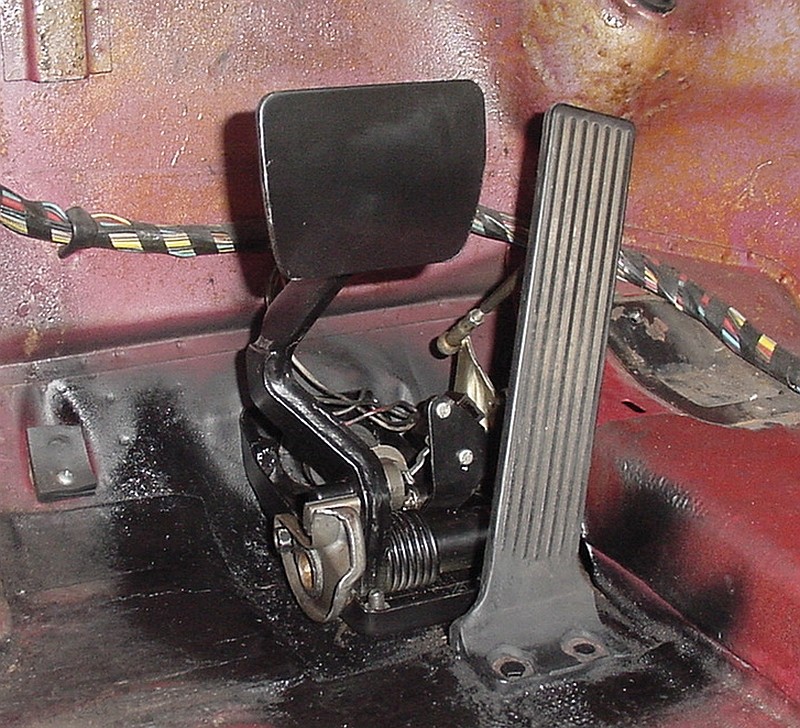

Boy, I just can't seem to get time to work on this car...too many things going. I did however get the sportomatic pedal cluster installed. Works beautifully.
What's wrong with this one...
The worst thing, one of our boy's car died and we gave him our Honda to get him through his last couple years of school. Consequently, we needed a car so we went out and bought a new Honda. OK...so I have a two car garage, one sbc914 goes insided and guess whose project car got kicked outside...yep this red one. (IMG:style_emoticons/default/hissyfit.gif) (IMG:style_emoticons/default/hissyfit.gif) (IMG:style_emoticons/default/hissyfit.gif)
rick 918-S
post Feb 15 2010, 11:28 PM
Hey nice rack! -Celette
Posts: 21,392
From: Now in Superior WI
Member No.: 43
QUOTE(computers4kids @ Feb 15 2010, 06:14 PM) *
That thing is bitchin! I second the VW sporto pad. Or maybe Mark Whitsell can make you a custom one! (IMG:style_emoticons/default/idea.gif)
