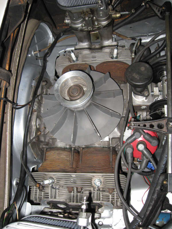

I'm working on a wooden buck to form more aluminum shrouds right now and wanted to remove the one from my car for measuring and fitting.
Normally getting the cooling tin off is a big project, easier if you drop the engine first.
In this case all it took was to remove the spark plug wires, coil and oil temp wires, the vee belt, 4 cheesehead screws, and unbolt one carb.
10 minutes later and it lifted out- Voila!
