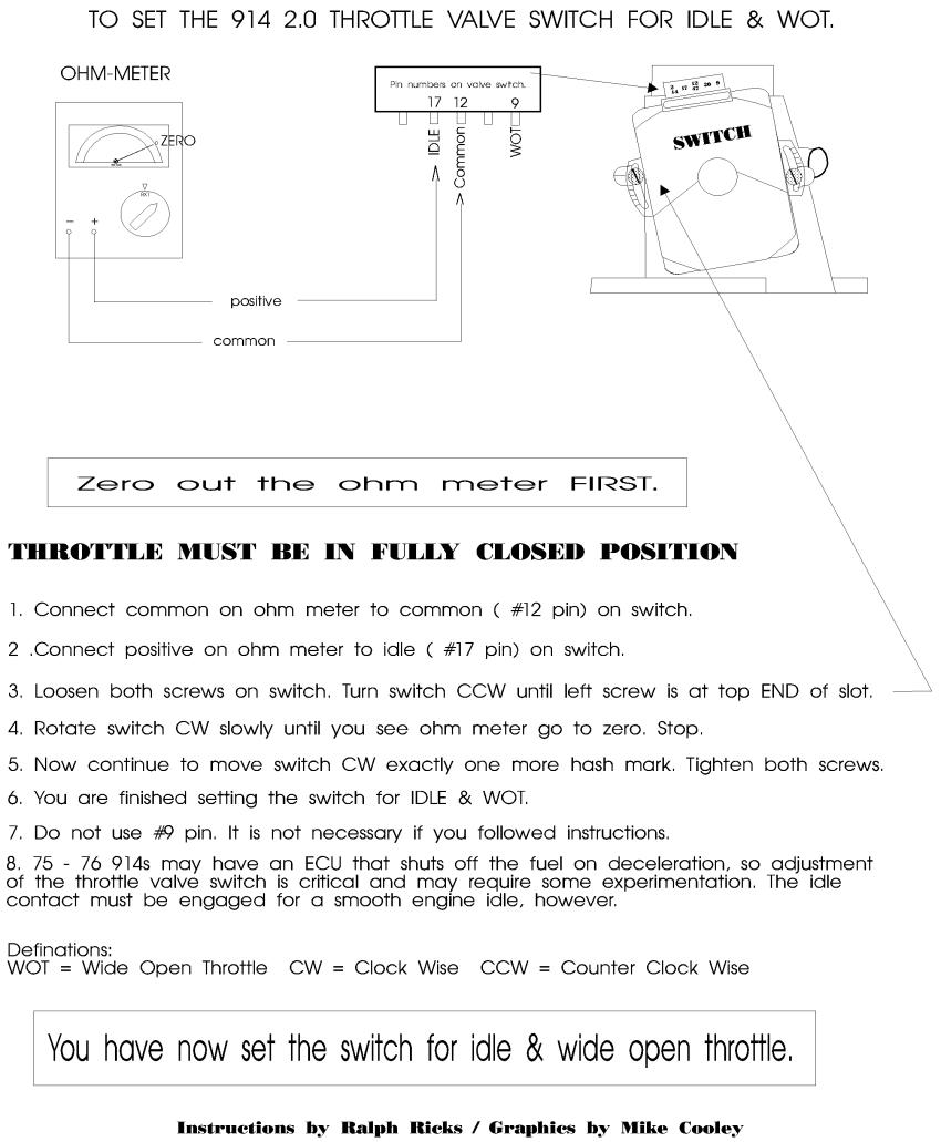

I purchased and installed the new TPS, but I'l having some difficulty in adjustment. Using the following adjustment guide, I tried to perform as directed:
But I just can't seem to get the Ohm Meter to go to zero.

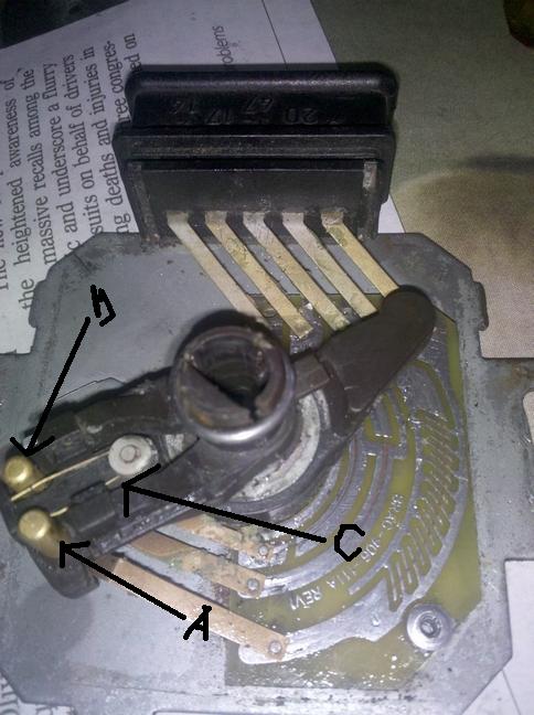

Now, please take a look at my TPS:
Should the wires "C" between post "A" and post "B" always short between these posts, or is there an offset where the wire only either contacts post "A" or post "B", but never both at the same time?
In looking at my TPS, can you see anything else which my be causing my problems?

Eric, the switch is designed with hysteresis (backlash) so that contact C is shorted either to post A OR to post B, but never to both simultaneously. In this way, the ECU can detect an opening throttle vs. a closing throttle.
But here is the problem with your TPS -- you've got a 2.0 liter board mounted in a 1.7 liter sensor plate. The 1.7 liter throttle rotates the opposite direction, so your mismatched sensor will never detect idle.

That would make sense. Thanks!
