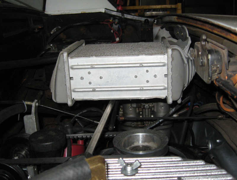

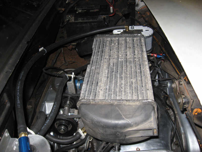

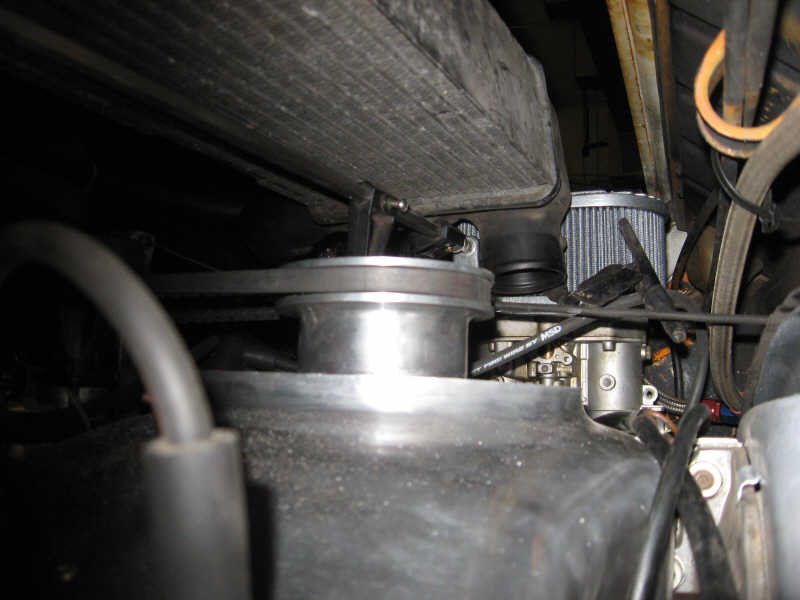

Here's an Audi TT intercooler sitting on my throttle linkage crossbar.
and a bigger Audi 5000 i/c

Brando   Chris, Would it be possible to show an intercooler...   Feb 7 2010, 05:19 PM
ottox914   Chris, Would it be possible to show an intercoole...   Feb 8 2010, 08:10 AM
Racer Chris   Would it be possible to show an intercooler place...   Feb 8 2010, 08:23 AM

Racer Chris   Here's an Audi TT intercooler sitting on my th...   Feb 24 2010, 12:16 PM
