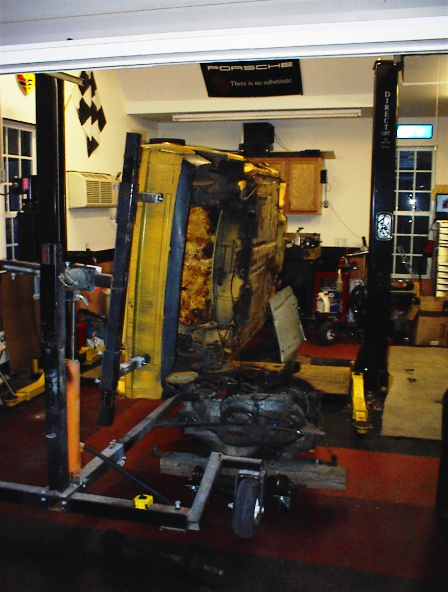

No going back now!
Was hoping to have the car blasted by now, but apparently my media guy is backed up. Attached Image
